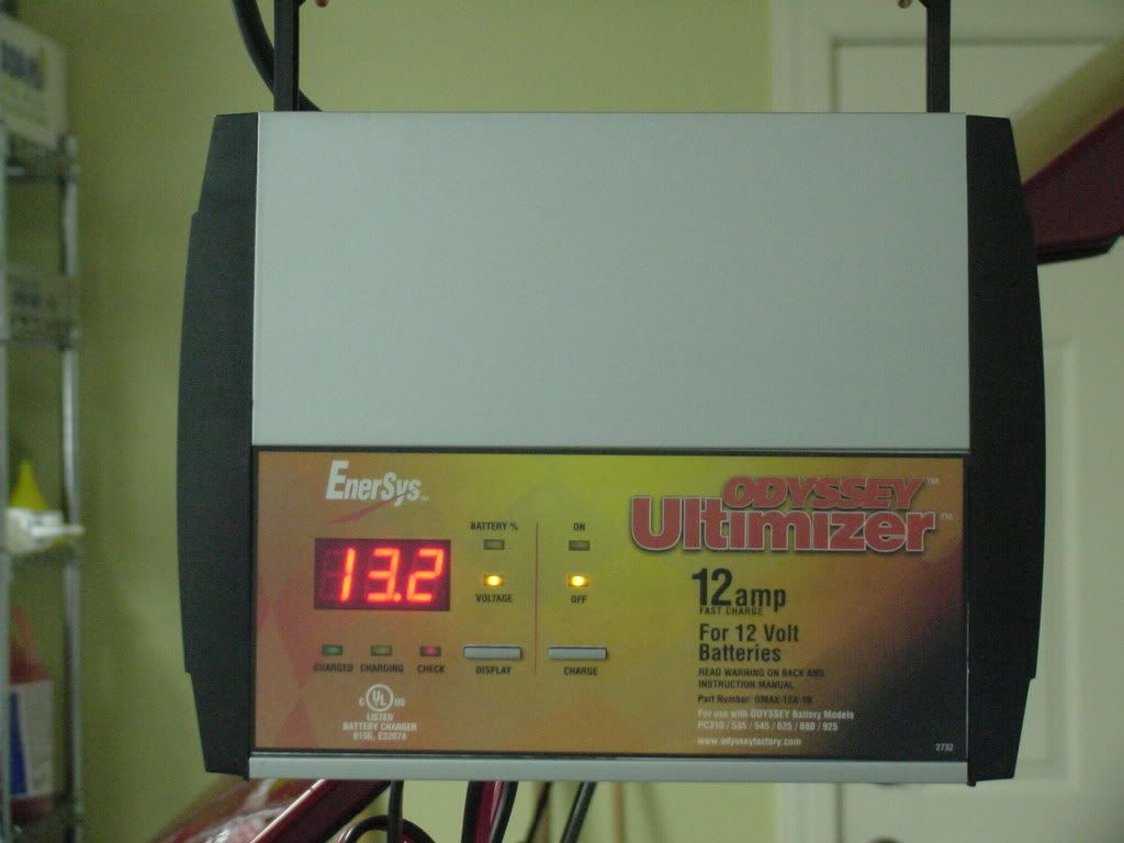

Here is a picture of what the displays on the Optimizer show with a fully charged battery :
13.2 volts
Which is a 100% charge.

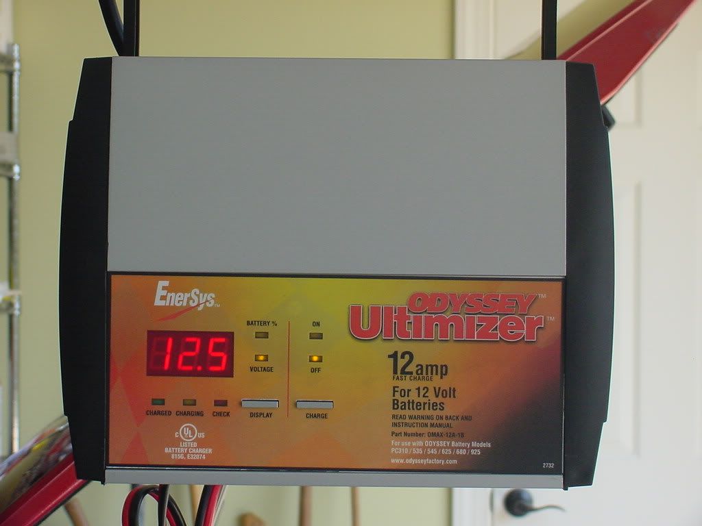

But let it sit for a few days and here is what you would see :
A 75% charge and 12.5 volts.
And let it sit for 7 days and this is what you see :
60% charge at 12.3 volts.
Now, granted that this "loss of charge" is what is often referred to as "surface charge", but it illustrates that there is a constant drain on the battery in an XLR.
