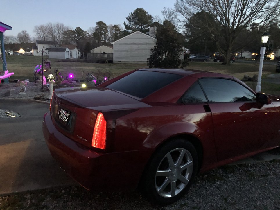

Update on car- Brake lights are flashing - indicative of theft system perhaps? I think this is Good News ? Thanks for the tip, Ian!!!

Melficient
The photo are showing the regular front and rear lamps only, they work with the bulb sensor on the dash when the Headlight Lights switch are on the automatic position to open and close them for the day/night lighting.
When the brake lights are on the third lamp and the brake lighting are brither.
Keep the low voltage charger on, until it indicate a full charge.
Doors and windows should be close for putting the theft system off, if you scare that they wont open tomorrow, then use an electrical wire with the necessary lenght, cut and remove the plastic covering the portion of the wire in order to get the inside of the other fines wires.
Insert the copper fines wires around the floor safety door handle, and secure them firmly on the handle moving up portion.
Get the wiring cable up in between the door glass and the weather strip and the door and try to see if it would really works, by pulling upward.
Tomorrow it will tell if the theft system is off….. if yes, the chances look good.
Good luck.
IAN :wave:
