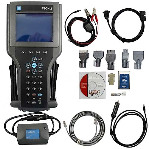

If you are confortable with the mechanic language and with and an electronic scanner.
A thecII is the GM scanner and a lot more expensive then the china clone one, were is it produced, I dont know, however we all know that many of them are made from china.
A thec2 is a china clone scanner and are in sales presently for $300 +/- presently on eBay, make a research on internet you will find many versions, however make sure you get all the components as shown on the attached photo, it is important, if you want that the unit would be productive.
Good search and luck.
