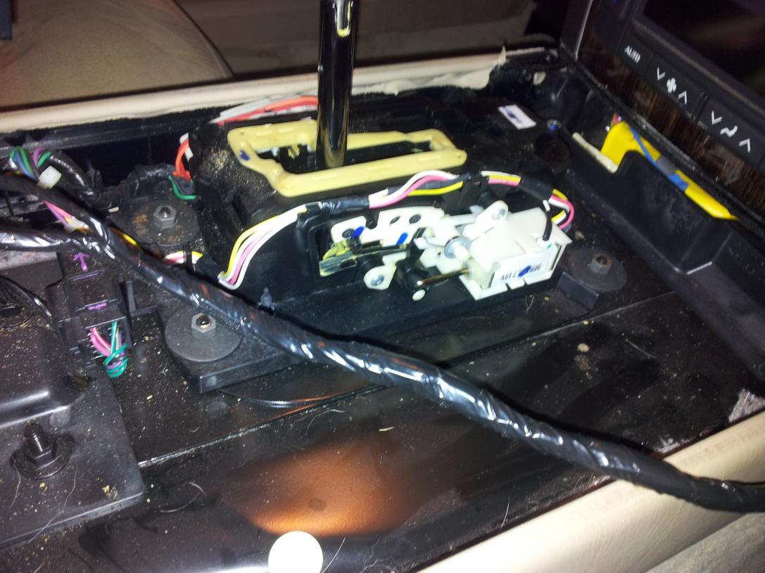

There is no way to manually release the gearshift solenoid without removing the shift cover trim. GM *MIGHT* have done something to correct this on later model year XLRs, but I'm not sure.

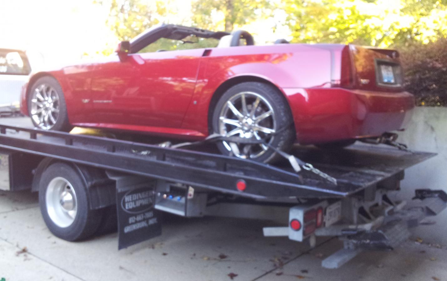

This makes flatbedding the car a nuisance, since you have to pull everything off the console before pulling it on the truck so the transmission disengages (of course, this is assuming you've lost all power and can't get anything to work). Yeah, it's happened to me a couple of times....

If there were changes later on it was after 2008. I had to disassemble the console in mine last October.
