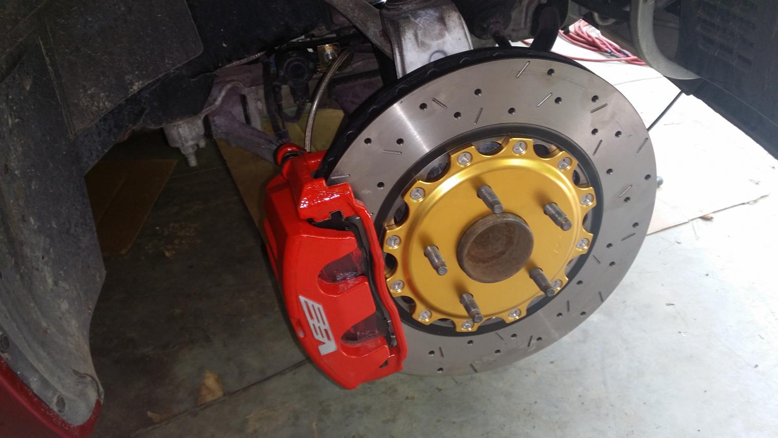

I just did this on my V and went with 2 piece DBA rotors in the front and single piece DBA in the rear. I went with Hawk HPS pads. I also changed the lines to braided while at it.

I LOVE the red calipers!! Did you paint/powder coat them yourself or did a shop do it for you?
What kind braided lines did you purchase and where? Perhaps, you wouldn't mind messaging me the detail on model numbers for the rotos and pads I'd be very grateful.
This is exactly the kind of set-up I'm looking for. Thank you so much for posting this!
I just painted the calipers. Not as durable as powder coated, but so far so good. I'll powder coat in time.
The lines are Goodridge.
Everything can be found here KNS Brakes

All ur rotors are powder coated and if yours are old they're probably rusted around the edge and close to the center, I would suggest changing out the rotors and go with GM parts no matter who you deal with, they won't dustup and make squeaky noises
Sorry my rotors are not powder coated, they're anodized. I'm very happy with my DBA rotors.
