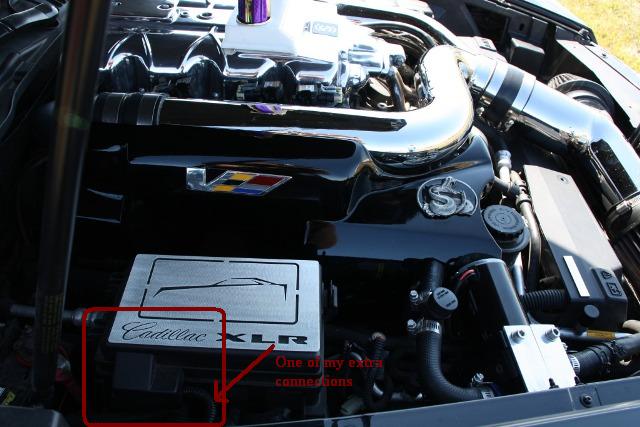

Yes, there is a positive terminal on the side of the fusebox. I use it to run power to my refrigerator and CarPC and accessories. For safety, I added in-line fuses to the these external power lines because it's nothing more than the primary connection for the battery cable, i.e., no different than hooking jumper cables to the battery terminal.
