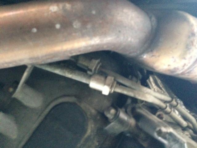

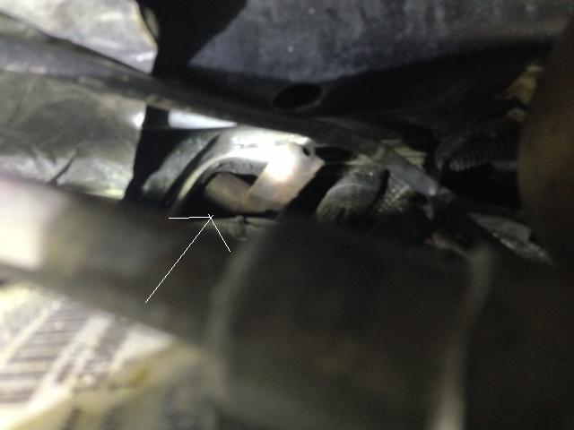

This little bit of maintenance got lost in the trunk drain plug check, but I would like to re emphasize the point. This little bugger is hard to find the first time. And having dealt with a clogged one, its extremely important for AC users (I usually don't, much to PJ's chagrin). Now I have the Super Chiller and the AC is run almost all the time, so I check it often after my first incident. :banghead:
Not to hijack this thread, but do you have a picture of this.
The first photo shows what you'll see from underneath when you're in the basic area. Look up, further into the passenger's side foot well, and you'll see the little L-shaped drain tube (highlighted with my flashlight and the cheesy arrow- it's actually black). It really does drain right on top of the exhaust pipe!
