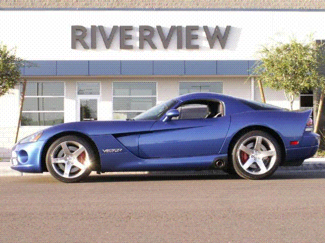

My '06 Viper SRT10, 505 hp, 500 lbs torx.......I used mid-grade fuel with no problems or knocking....ran fine. [sold this car in 11-13]

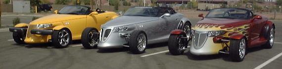

Our Prowler's manuals say to use 'premium fuel' in their high-output V6........use regular unleaded only > 145,000 miles driven total on all 3,,,,,no problems or knocking.... all run fine.
