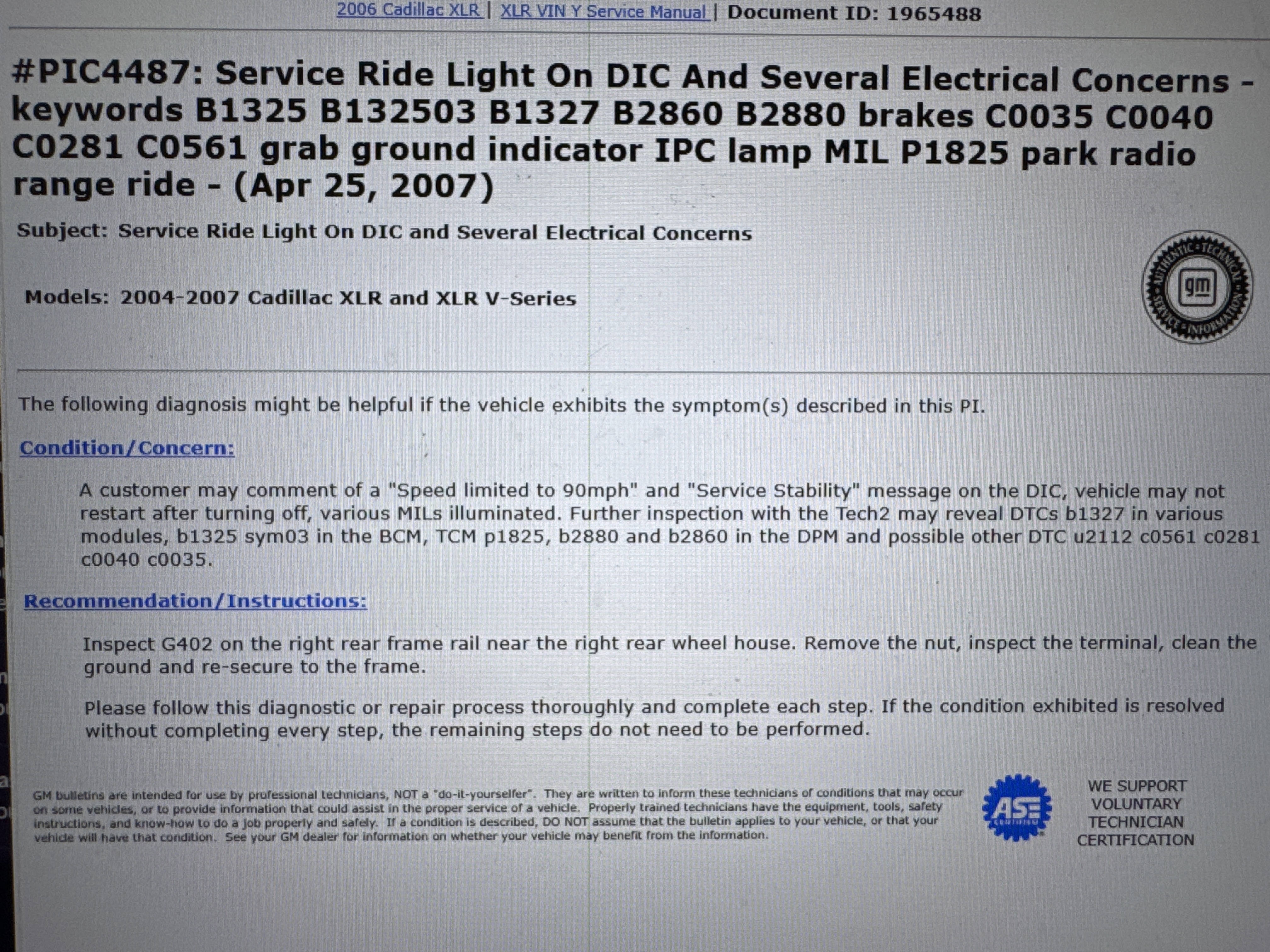

Campaign PIC4487 may have some insight, G402 has the note “Transmission harness, on the underbody, on the RR frame by the RR wheel well, ground for CKT1050.”

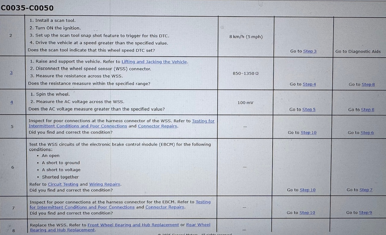

And the diag table for c0035, with the values you can check with your multimeter. Step 9 is cut off but it’s “replace EBCM” and step 10 is just “clear codes and test drive.”
