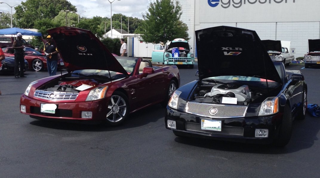

Hey Raz -
Mike delegated this response to me since I'm the one who started the XLR addiction. :lol: The black one is an '07 V and is Mike's, the red one is an '06 base and is mine (although we each drive both). I'd always loved the looks of these cars before I had any idea they were hardtop convertibles, that was just the icing on the cake! So, Mike surprised me with the red one as an anniversary gift in 2010. Then, when he kept texting me at work on nice days that he was taking mine out with the top down (I work too far away to go get it at lunch like he was doing), I told him to get his own! So he got the V in 2012.
The base had been a daily driver but was very well taken care of, had about 32k miles on it when I got it, now has 46k. The V had 15k miles but actually the exterior was in rougher shape than mine. I'm "detail girl" (because I like shiny things! :chuckle) so I fixed that part up; Mike's the electrical/mechanical guy. The V now has about 22k miles. They are an absolute blast to have!
The joint picture in the avatar is from the Bowling Green plant when we took both of them on a forum trip. We also play "cat & mouse" on drives around town. It's fun to see people going "What the heck is that ... wait there's TWO of them." We do car shows together as well. Below is a picture of us at a show. Enjoy YOUR ride!

Too cool to hear of a girl/guy pair of these beautiful roadsters, our story is bit similar but being my wife is a bit intimidated by the V we got her a 2012 CTS Sport Wagon in black, very cool looking car for a wagon. Funny you mention the Bowling Green event as I am heading to this years meet, I hope to see other XLR's there so I'm not the odd ball without a Vette. Thanks again for the info and reply, very enjoyable to here about other XLR owners. Later - Raz
