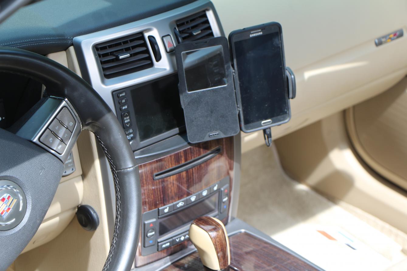

My point is that it actually less taxing on your attention. It's nice to have any turn by turn navigation instructions automatically mute (and resume) the music. It also prevents missed calls due to music louder than the phones internal ringer. Handsfree phone conversations is a big reason for the Bluetooth interface, not to mention voice dialing and navigation commands that work. All done without my eyes leaving the road. These are all valuable assets to me, YMMV
I don't think I would mess with Bluetooth interface if I was just going to use an IPOD. I haven't used my IPOD since my phone is capable of storing 32GB of music without having to have an additional device.

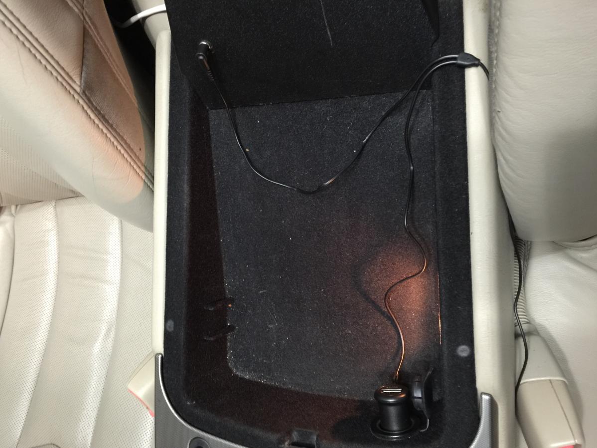

I ran the power for the LGB-1 from the same points as the BTC455 (behind the armrest power socket). The amp did the trick for getting the levels up but did create a small amount of whine (ground loop?) noise that is noticeable during dead air times (between songs). I can't notice it at normal volumes. I have purchased, but not installed yet, a filter that I expect to resolve the minor issue. Amazon.com: PAC SNI-1/3.5 3.5-mm Ground Loop Noise Isolator Works with iPod/Zune/iRiver and Others: Automotive
I think you are right on regarding losing XM with the amp plugged in to the AUX-2.
I hid everything inside the console including all the 3.5mm jacks and drilled no holes. I do not ever need XM and never need to unplug anything. I just routed the cable inside the console from where I mounted the BTC455

There is not a lot of extra room, but it does fit. Quick taps for the initial connection, everything else is soldered and shrink tube. My center console power socket is switched, just like the one near the drink holder, not aware of the jumper you're referring to. It is a delayed off and happens later than what you may expect. If you have a power adapter with an LED indicator, plug it in and check it in an hour after shutting down. I seem to remember it was about 45 minutes but will not swear to it.

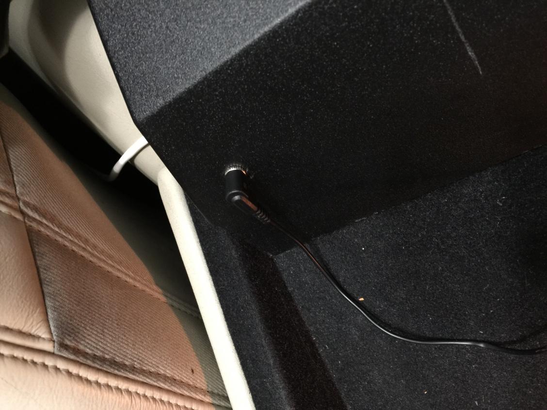

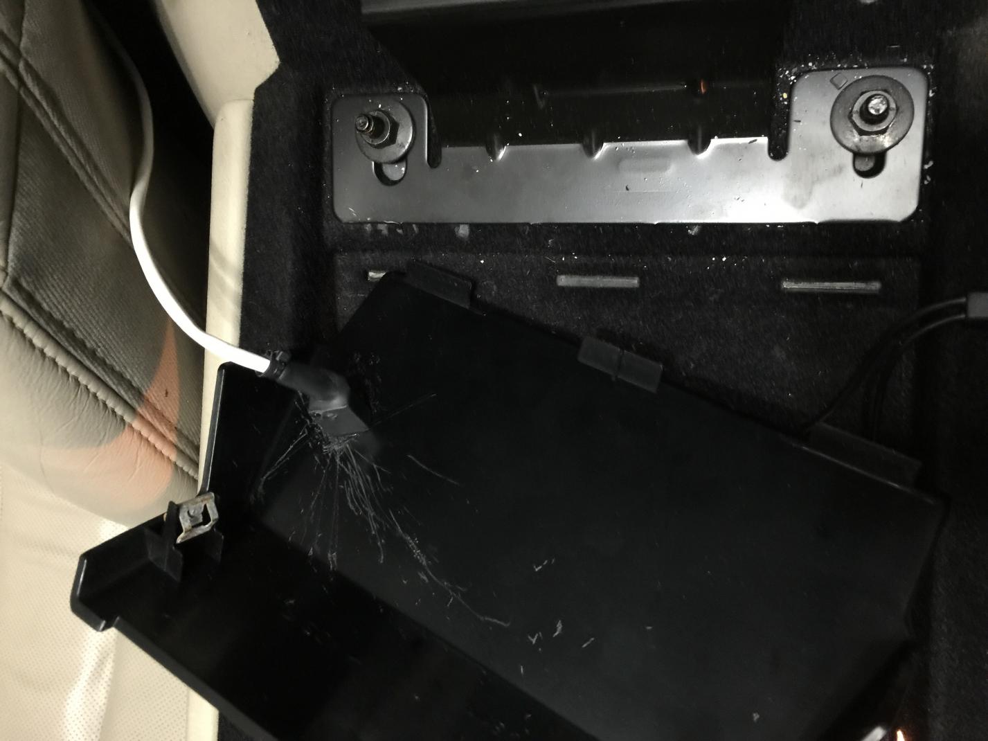

The filter works great and solved the issue completely. All the levels (FM/WX/CD/AUX) now match without any issues or noise. Audio quality is CD+ and much better than XM or FM. The AUX may be a little higher but I could adjust the amp gain to get an exact match.
Everything fits inside the console plus a power socket and USB power adapter for charging my phone where I hide the cable that exits the trim by where the phone is mounted. Just be sure and position things so that the two switches and cup holder do not interfere.
All and all, I am very pleased with the set up.
