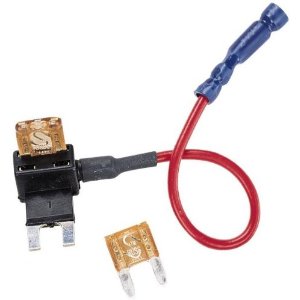

The OnStar module is located in the trunk on the passenger’s side up near the passenger’s seat. Just pull back the side trunk carpet and there it is. BLUGM-11 takes about 1 minute to install with no tools required. However I strongly suggest you change the connection at the fuse block so the BLUGM-11 shuts off when the car shuts off. The can be accomplished with a Bussmann BP/HHH ATM Add-A-Fuse which was about $5 at pep Boys (Picture below). By plugging the black end into the fuse location for the heated seats, I jumped the power from them to OnStar. I then plugged the red wire into the right side of the onstar fuse terminal. I chose the heated seats because they shut off when the car shuts off and the fuse location is close to the OnStar fuse.
My phone connects automatically when I enter the car. It disconnects when I shut the car off or if I manually disconnect it at the phone. The car radio will go silent for 3 seconds when the phone connects. The car radio will go silent when you make an outgoing call. The car radio will go silent when an incoming call is ringing (even if your phone is on vibrate). The car radio will go silent when an incoming text is ringing and my phone is on normal mode. This is annoying because if you get a lot of texts the radio will continuously go silent for 3 seconds. I can avoid this but putting the phone on pager mode. Incoming texts will not cause the radio to go silent in pager mode. </SPAN>
I do not use the voice dial on my phone so I can’t comment how well it works when connected to the XLR.</SPAN>
I can tell you the sound quality on the phone calls is perfect. I have many people telling me they had no idea I was in a car. The Neo BT BLUGM-11 comes with a quick start guide telling you all the fancy things you can do with the OnStar buttons on the mirror. I tried some of them with no success. Honestly, I don’t need to conference call while driving so that does not concern me. The speaker volume is adjusted with the controls on the steering wheel only. The manual says you can adjust it with the volume control on the phone (this did not work for me). The manual also says you can adjust the volume with the buttons on the OnStar mirror. This also did not work for me. Use the steering wheel volume controls.</SPAN>
The Neo BT BLUGM-11 has a 3.5mm stereo phono plug jack built in. This is because the calls are in mono but you want to listen to music in stereo. It is possible to stream music thru the BLUGM-11 without any further connections but the music comes out of the little OnStar speaker and sounds like poop. If you want to wirelessly listen to music, you need to connect the 3.5mm stereo phono plug on the BLUGM-11 to the aux input on your XLR radio via a phono cord. But wait, the stock XLR radio does not have an aux input jack? That right, but you can order one from Ray Kawal (search his name on this site for posts about his aux cords). I have music streaming thru the BLUGM-11 into the aux input jack . The quality is pretty good, about the same as XM/Sirius radio. </SPAN>
Excellent call quality and ease of use is the only reason I am not returning this product. My opinion is that there are many other cheaper Bluetooth adapters that will do just a good as the Neo BT BLUGM-11. However if you want to retain the stock look of your XLR and use the stock OnStar components this is the only device that will do it. The other advantage is the Neo BT BLUGM-11 can be removed in less than a minute if you sell the car. It is a universal device that will work in any car with OnStar. </SPAN>
