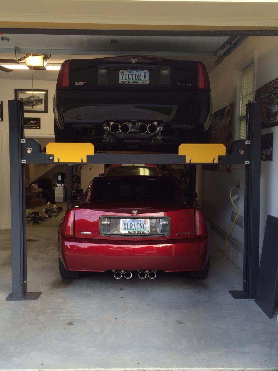

My new toy came in last week.......4 post lift. :rocker:
Now I can stack the XLRs and watch Amy just about have a nervous break down in the process. Especially since Beauty is on the bottom.

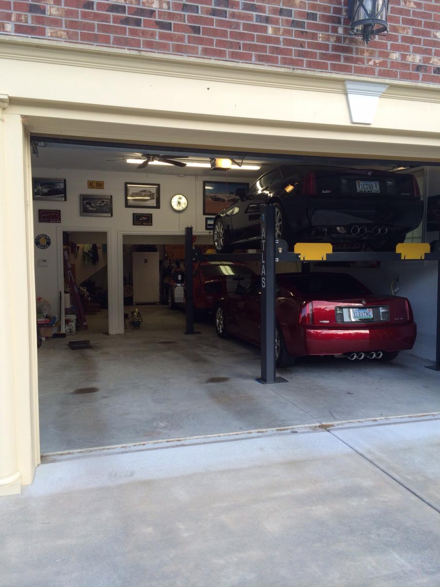

It is an Atlas Lift. I purchased the lift from Advanced Auto Parts so I could deal with someone in person but they in turn purchased it from Greg Smith Equipment. I paid the exact same as if I'd bought through Greg Smith.
Here's the link:
Atlas® 408-SL 8,000 LB. 4 Post Lift
It is heavy but 2 friends and myself put it together in about 5 hrs and we were taking our time. There are numerous brands and "duty" levels out there on the market but the Atlas 408-SL model fit my bill. It has an 8K lbs capacity which is more than enough to lift the XLRs. :laugh:I also purchased the caster kit for my lift so I can move it around as needed (empty-no car on the lift).

My ceiling is 10' 5" but it still would've worked with a 10' ceiling. My garage door, when opened, is my only limitation.

Actually the panic was bigger when Beauty was the guinea pig on top & I get texted pictures of her looking smacked up against the ceiling. :eek: And horrifying to watch her go up in person as I'm thinking don't-hit-the-CEILLLINGGGG!!! :bash:

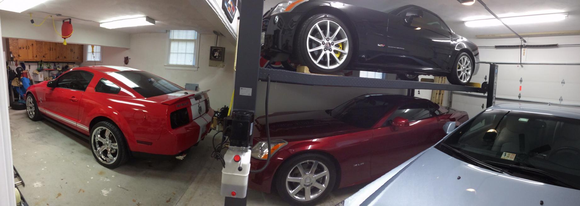

If you have not already done it, I suggest getting some good stiff cardboard and drop it in between the ramp rails so the upper car can not drip on the lower car......just in case. (stop by an appliance store, they can likely provide something big enough and hopefully rigid enough as the thinner stuff will sag) Also, is it safe to assume you installed the height limiting blocks so you can't go too high?

The lift came with 4 drip pans so the oil leaks are covered. :twist: I haven't installed a limit block but I did marked the rail with tape so I have a reference point on when to let go of the button. Since I made my ceiling 10'5" the lift I purchased will not go high enough for the XLR to hit the ceiling but if my garage door is open, that's a different story. Although, I make sure my VALLET switch is ON!!! I don't want any unauthorized trunk openings.
Amy was already checking out the underside of both XLRs and plotting a detailing strategy. :chuckle
I was going to purchase the "drop in jack" but I figured I would get the lift in and get familiar with it before I added the extra cost. The jacks are on my list of add-ons.
