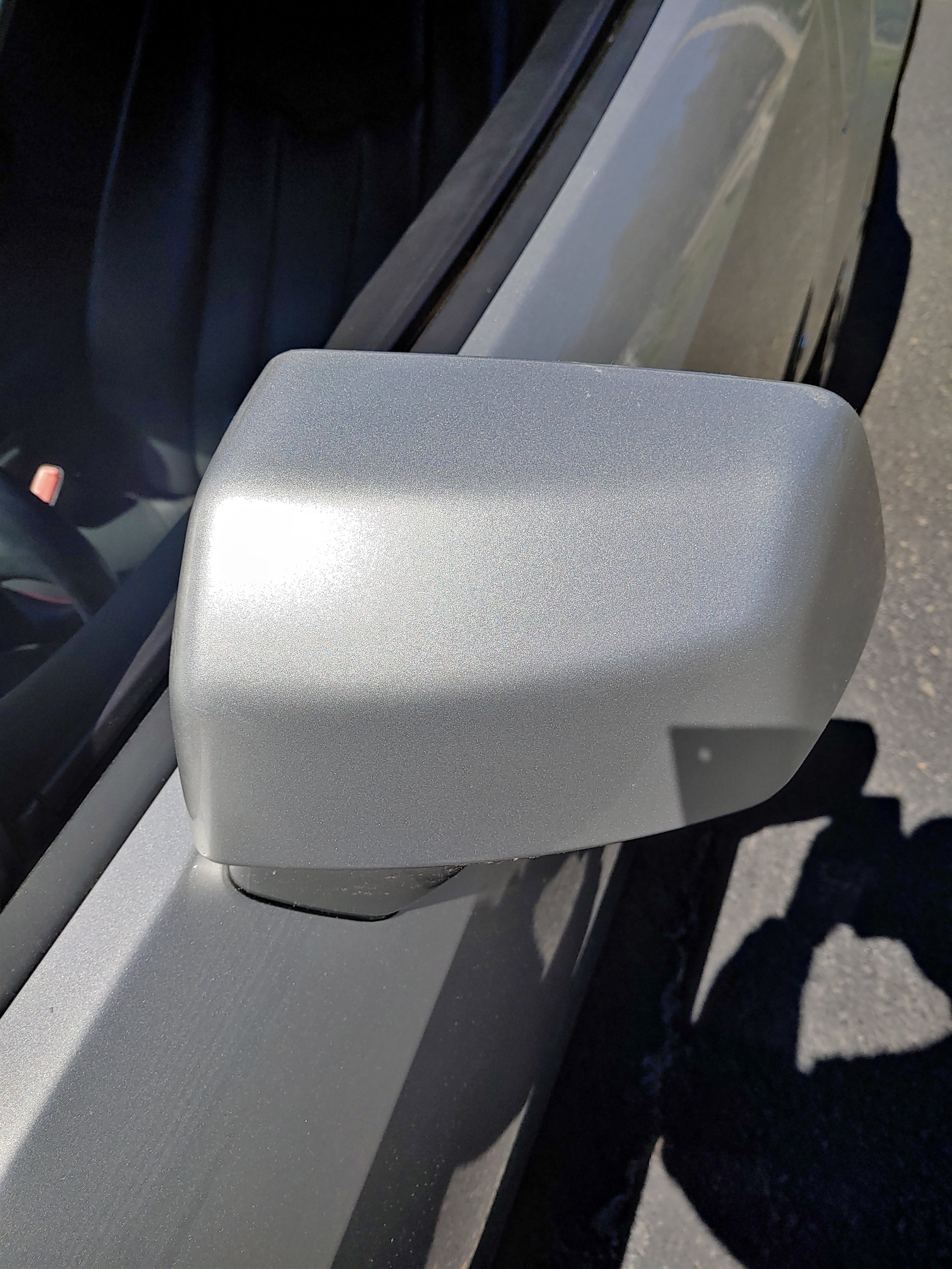

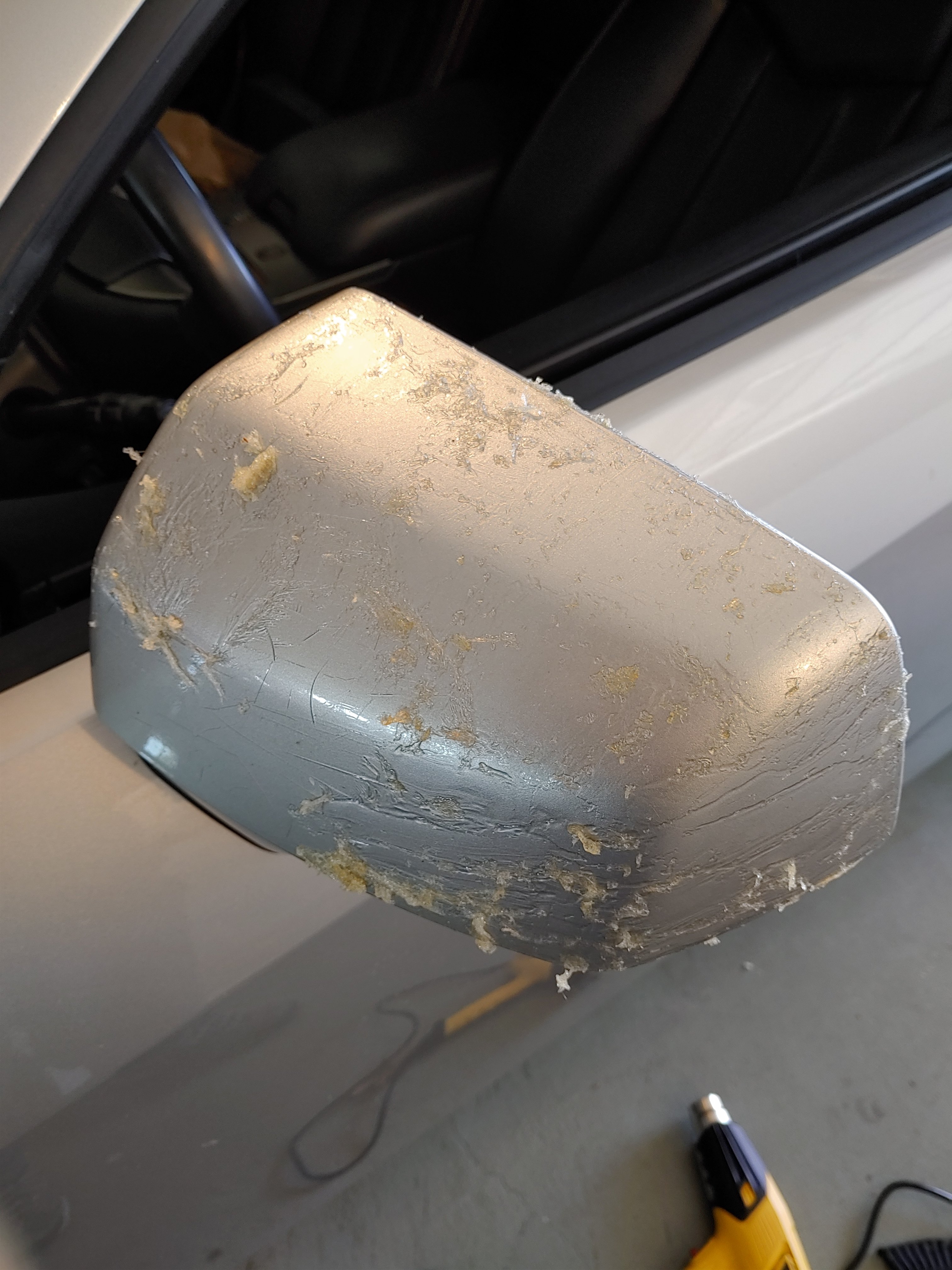

Hi, just finished both mirrors. Used a heat gun and ice scraper to take off most of the plastic/residue and then just used the heat gun/towel to remove the rest. Turned out perfect. Here are in progress and after completion. Took my time, heat gun on medium, approximately 1 hour of work time per mirror. Now I have to really think about the front hood section and what I'm going to do as that is a much bigger area and have to protect front grill and side by each headlight assembly.
Didn't actually have to use goo gone. Get most off with scraper then just one more use of heat gun wipe off what was left with towel while applying heat
