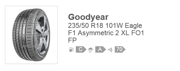

A fantastic regular tire, looks great and drives great.
No thanks to the run flats!

I have these tires on mine. Have put 15,000 miles on them. They handle speed, bumps, potholes and ride great. A hundred mph feels the same as 50. Very smooth tire and they never lose air.

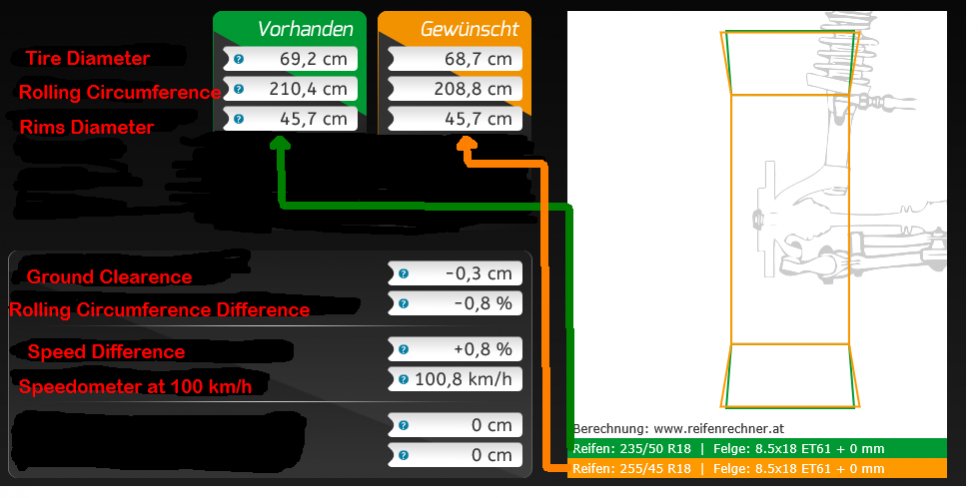

as anyone changed the zsize to 255 /40/18 or do you just run the 235/50/ 18. Does not look like anything in a 245/18 is as tall as the 235/18
