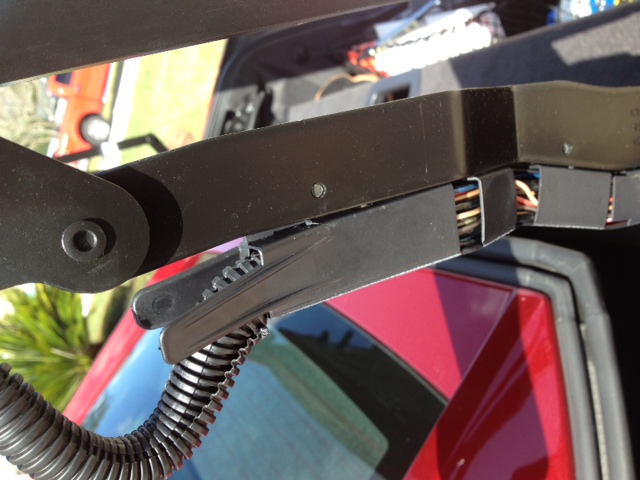

ok here is a good one. Went to wash my car today at the touchless car wash around the corner from my house. got back home to finish drying her off.i opened the trunk and noticed along the hinge bracket that i have exposed wires. Walked over to the other side of the car and noticed that the bracket was closed but had some other sort of cover over it. So i just snapped the one piece back in but might have to go to the dealer or auto store and find a cover for that other exposed area? :dunno:
View attachment 2763drivers side
View attachment 2764passenger side
I really would not be too concerned. It appears the wiring is being held in place and there is no risk of it getting pinched.
Another concern is, the about the wiring getting wet. The passenger side has a protective sleeve and brackets. The drivers side just has the one bracket that I snapped back into place, and no protective sleeve. But I guess as long as the top doesn't go up and down where I have to open the trunk then I'm alright unless I get a blowing rain storm.
Guy your wires ( are not bare ) they are plastic coated and they can't get wet inside a closed trunk as long as there not loose or hanging out to catch anything you should be fine!
Ok thanks.
