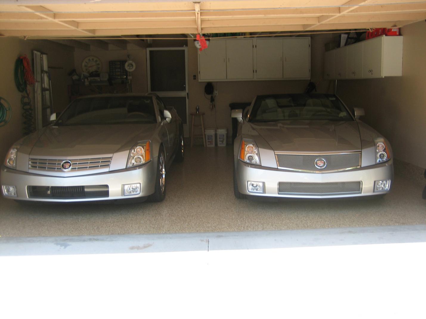

Click on my pictures on my profile or here. Their is a picture of both my XLRs facing out of the garage and that bumper looks the same for the 04 as the 06 :dunno: Almost twins.jpg

Click on my pictures on my profile or here. Their is a picture of both my XLRs facing out of the garage and that bumper looks the same for the 04 as the 06 :dunno:View attachment 3137
Yea you can definitely see that the acc isn't on the V version as it is on the base.

Rod, Check my photos in my profile and there is a pic of my 04 & 06-V facing out in my garage, even blown up, and I can't see any difference in the skin except probably the price, which I can't see.:lol:
It would appear that the curvature of the upper corners of the opening for the lower grille are slightly different. It looks like the V has tighter corners than the base.
