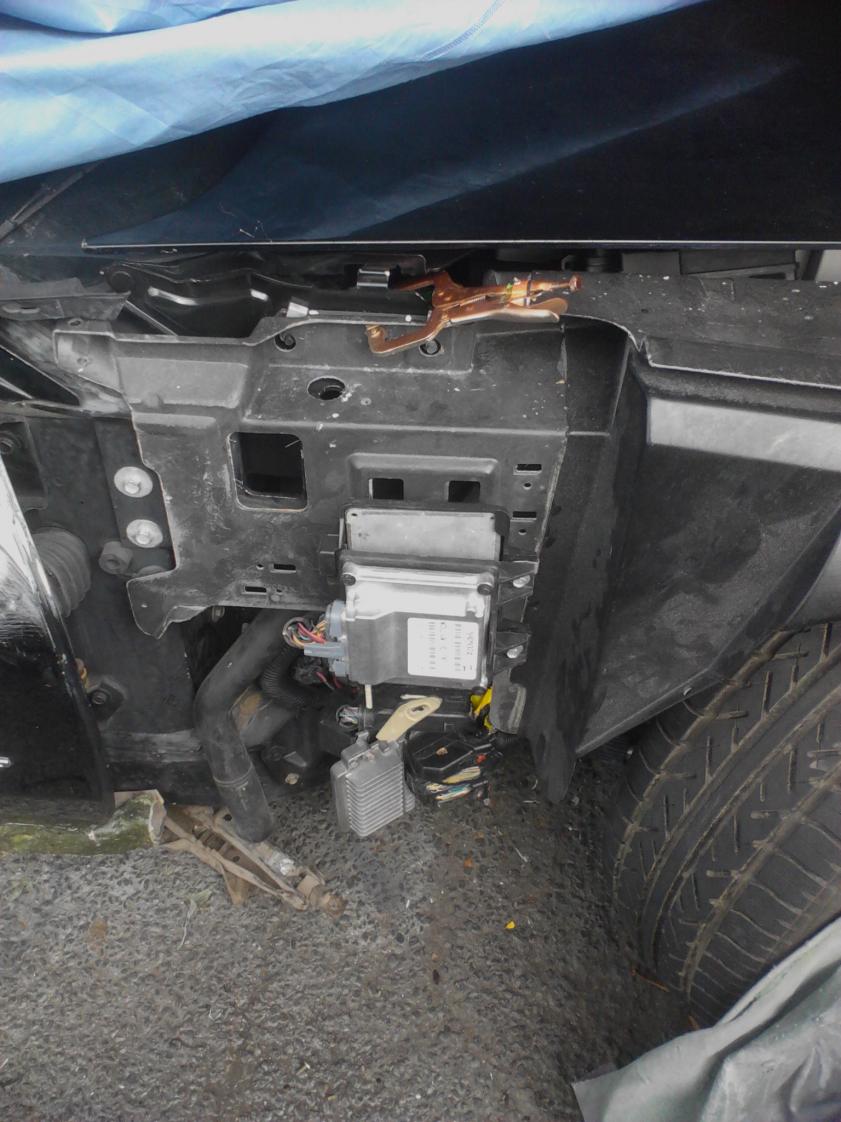

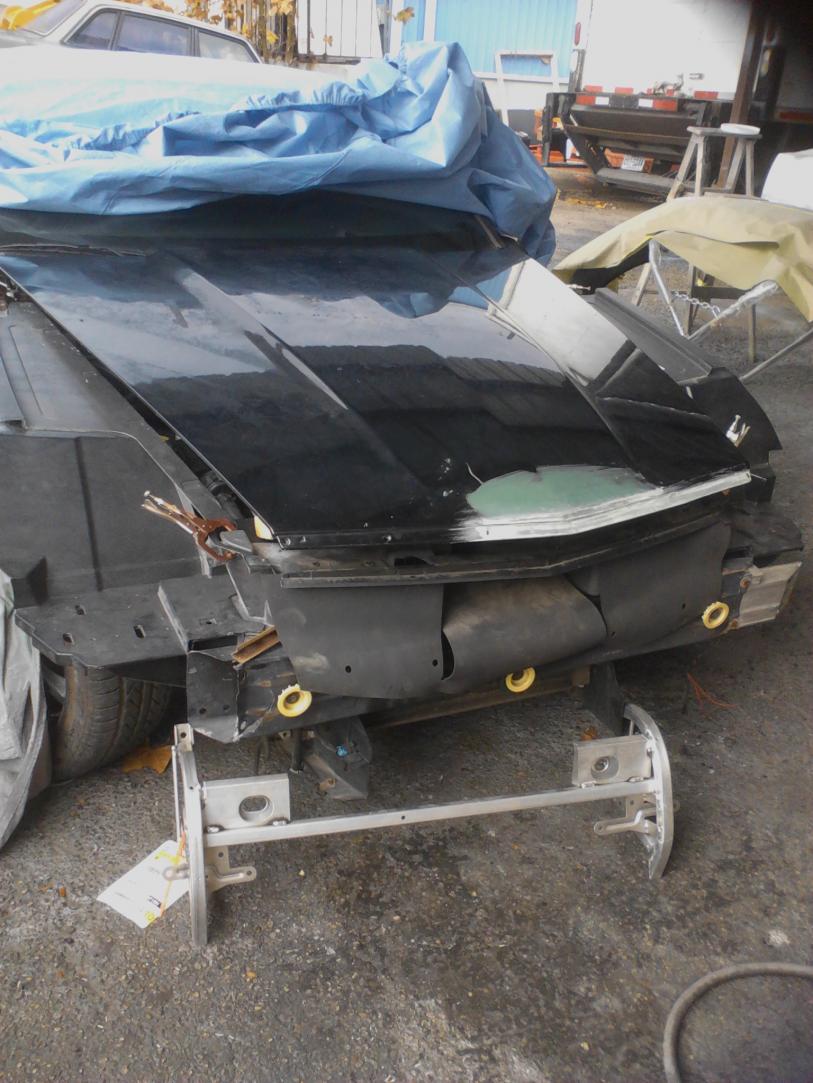

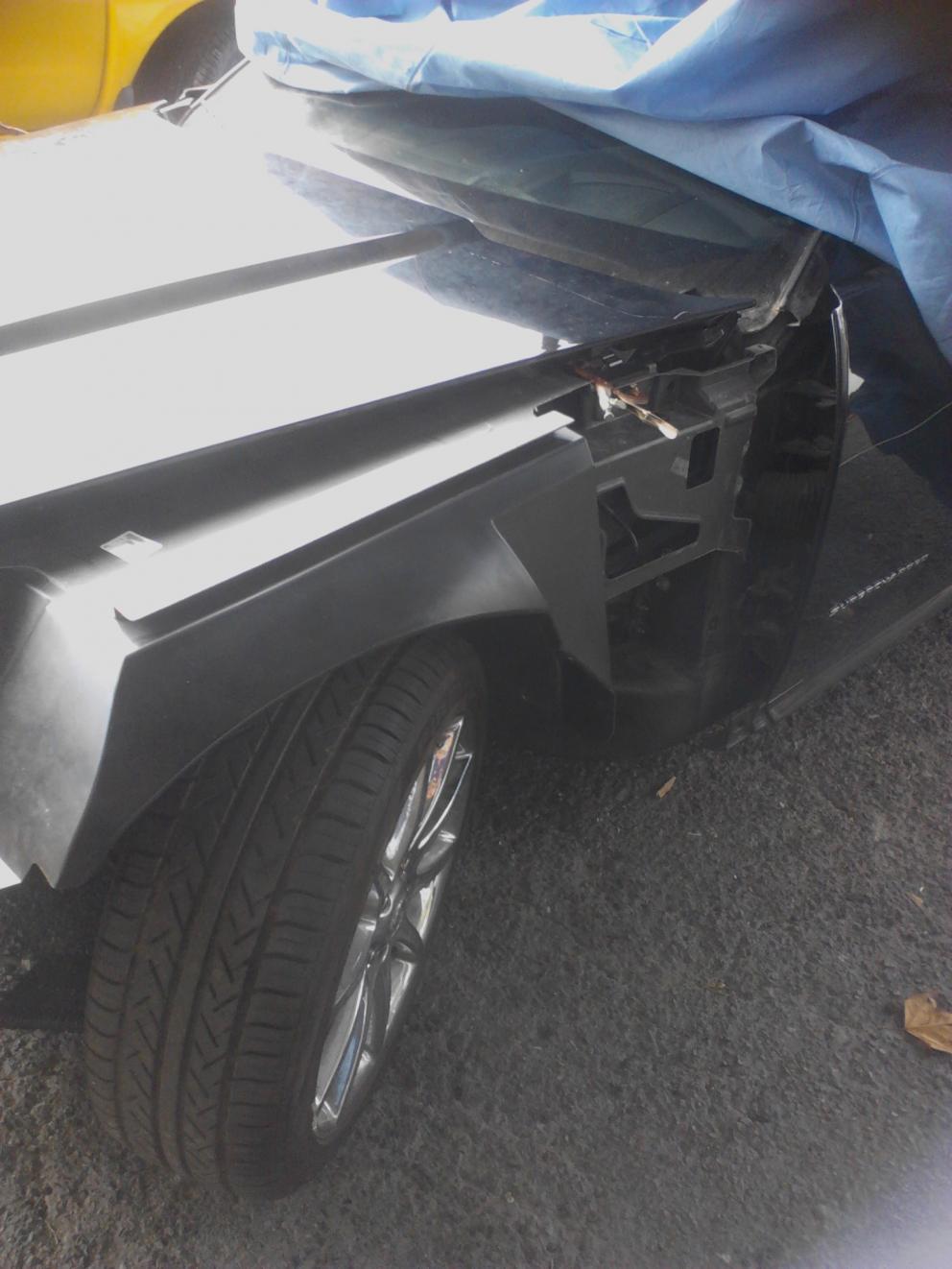

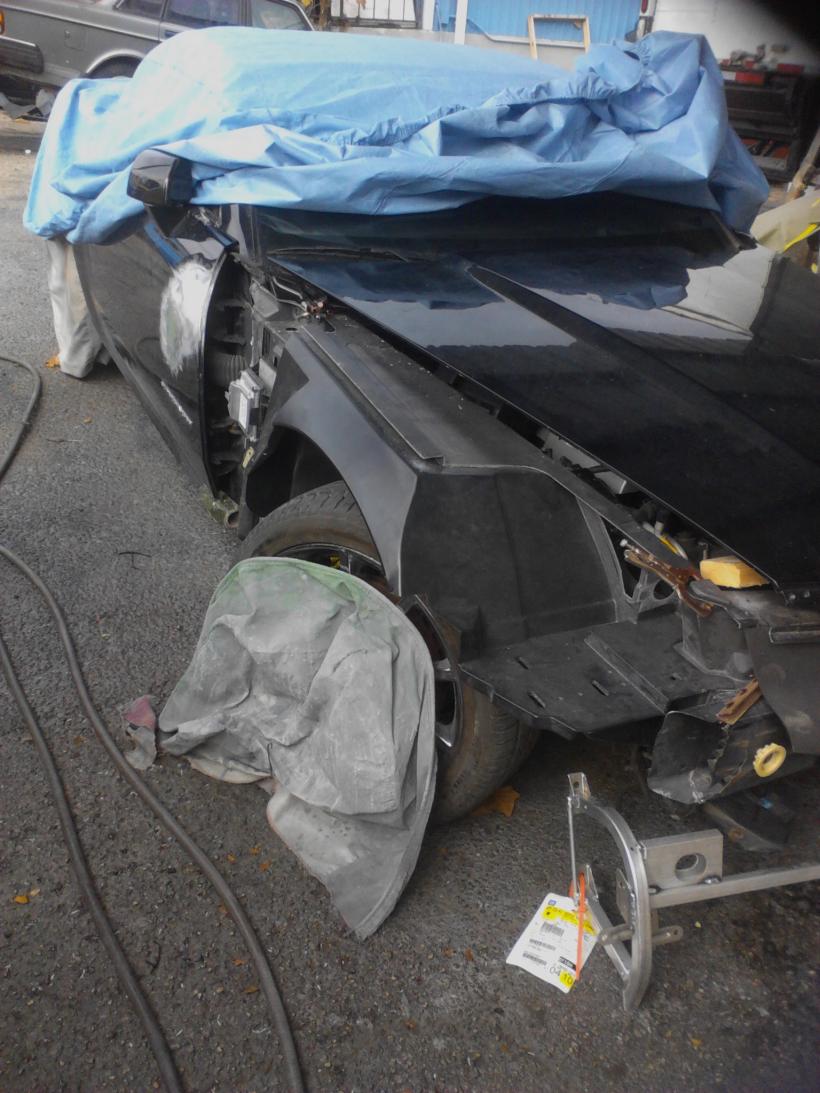

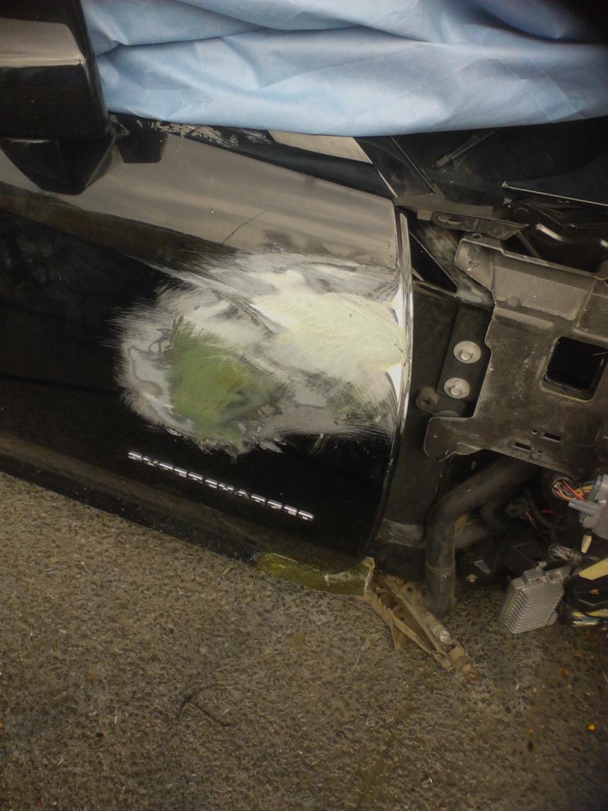

IMG_20140110_113233_0.jpgIMG_20140110_113258_0.jpgIMG_20140110_113307_0.jpgIMG_20140110_113437_0.jpgIMG_20140110_113225_0.jpgpic 1 is the RF wheelhouse with electronics attached and clamped in place. 2 is the fiberglass repair to the hood also had to repair the strut mount under the hood. I tried to find a V hood to no evail but the repair was not that bad. 3 is the LF wheelhouse clamped into place. 4 is a better shot of the RF wheelhouse and 5 is the fiberglass repair to the RF door but does not show repair to the hinge area that was cracked and allowed the door to drop about 1 inch when opened that would have been an expensive replacement so I am glad that I was able to repair it. Waiting for a fastener order from GM to finish aligning the front fenders so the adhesive can be applied. GM dealer referred me to a local auto paint store for the adhesive and special applicator gun made by 3M. ROCKY:wave:

View attachment 3610View attachment 3611View attachment 3612View attachment 3613View attachment 3609pic 1 is the RF wheelhouse with electronics attached and clamped in place. 2 is the fiberglass repair to the hood also had to repair the strut mount under the hood. I tried to find a V hood to no evail but the repair was not that bad. 3 is the LF wheelhouse clamped into place. 4 is a better shot of the RF wheelhouse and 5 is the fiberglass repair to the RF door but does not show repair to the hinge area that was cracked and allowed the door to drop about 1 inch when opened that would have been an expensive replacement so I am glad that I was able to repair it. Waiting for a fastener order from GM to finish aligning the front fenders so the adhesive can be applied. GM dealer referred me to a local auto paint store for the adhesive and special applicator gun made by 3M. ROCKY:wave:
