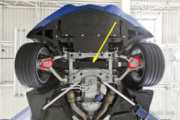

spring adjusters
across the front and read of the car are transverse springs. instead of coil springs like most people are familiar with.
under each transverse spring (at each end) is a large bolt with a rubber pad on the end.
this lets owners adjust the spring tension to adjust ride height ride quality etc.
usually nobody messes with these except the dealer and maybe a performance shop.
over time the rubber boot part can wear or snap off, resulting in quite a noticeable change in ride quality or stance.
example one wheel is much lower in the wheel well than the other 3... probably broken off the rubber end.
here is the thread that discusses the rubber adjusters, how to replace them, etc.
https://www.xlr-net.com/forums/cadi...lt-replacement.html?highlight=spring+adjuster
here is a pic of the underside of a corvette. front end.
the parts look the same even though its a different car.
see the transverse spring yellow arrow.
then above each red circle , above the lower control arm, is where the leaf spring presses the rubber adjuster down against the control arm to give the suspension the spring tension.
