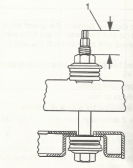

Rear End Ride Height Measurement:
1. Park the car on a flat surface.
2. Settle the suspension: Lift upward on the center of the rear bumper1.5”
3. Let go.
4. Repeat this twice more.
5. On each side, measure the distance between the lowest point of the Ball Joint and the center of the front side of the Lower Control Arm mounting bolt.
6. Perform steps 2 & 3 twice more, measuring the gap after the car settles; for a total of three measurements. (See Figure 1.)
7. Take the average of each side’s three measurements.
8. For the stock F55 suspension, the measurementshould be 4.7 inches/119 mm, +/- .25”/6.4 mm.
This procedure assumes you have a J 42854tool to make the measurement. A simple measurement tool can be constructed from a piece of flat stock with a level attached and placed against the bottom of the mounting bolt and the gap measured with calipers from the top of the flat stock to the center of the ball joint.

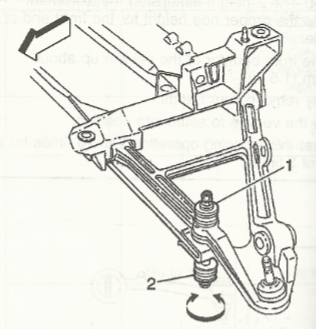

Rear End Ride Height Adjustment:
1. IMPORTANT: One complete turn of the transverse springbolt is equal to 5/64” / 2mm of Y axis travel.
2. Loosen the locking nuts on the top of the transverse spring bolts. (See "1" in Figure 2.)
3. Adjust the trim height by turning the transverse spring bolt. (See 2 in Figure 2.)
4. Measure the trim height again using the previous procedure.

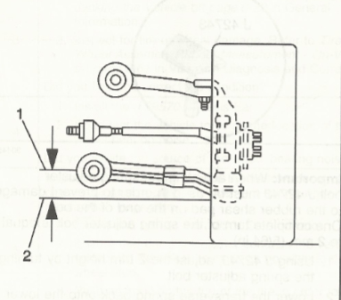

5. IMPORTANT: Do not exceed the maximum differencebetween the right and left rear transverse spring bolt stud heights. (See Figure 3.)
6. Tighten the locking nut finger-tight and measure the transverse spring bolt rear spring stud heights. The maximum difference should be .196” / 5 mm (See Figure 3.)

Note: Figures 1-3 as depicted below are from left to right.
