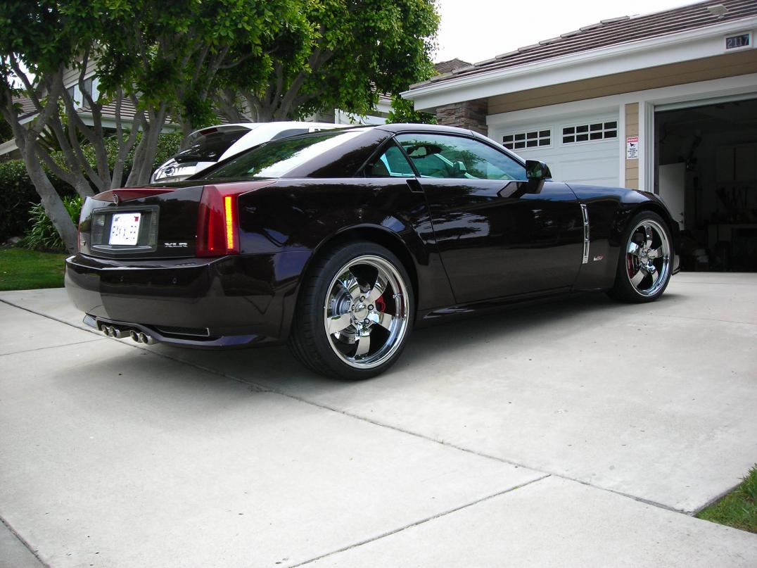

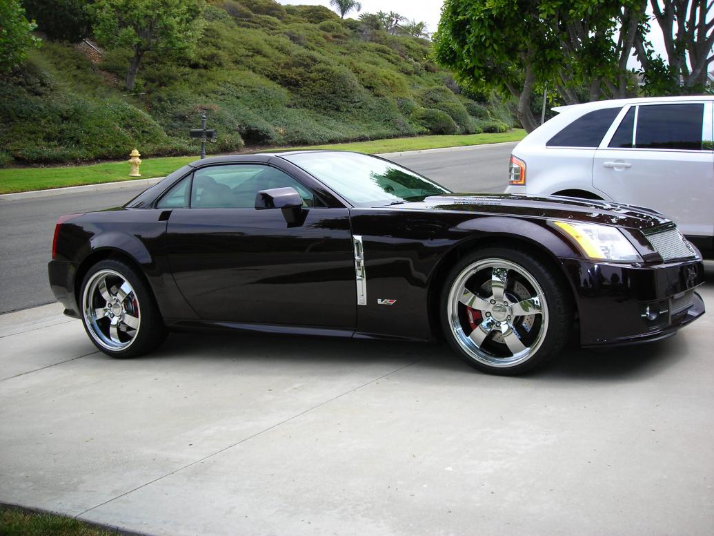

Here is what the new tires and rims will look like: :thumbsup

hey pak,
nice wheels , it will be worth it in the end!!
i wish i could throw some 20's or 19's on my 07,
but in the philadelphia area, winters suck and destroy the roads,
potholes are everywhere from january to may...
even though i store the car for 5-6 months a yr,
the roads are terrible way to long, and even once they are fixed they are too bumpy
for such low profile tires.
is your front bumper skirt stock?
or did you add a little extra trim along the bottom edge?
i really like the 09 updated front and rear,
i am not in love with the side grills though,
