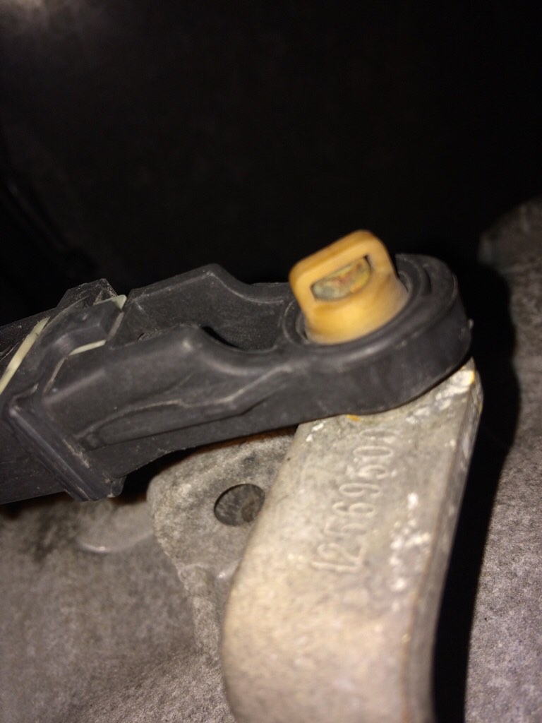

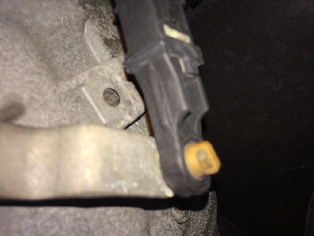

Thanks for the pic helpful. Now on the trans lever is there a round stud that the clip attaches too,or is there a ball stud ? Maybe ill jack mine up and see for myself. Then I can see the condition of mine.
Just from the pictures looks like the white bushing probably dry rotted,cracked causing it to fall out. Then the black clip fell off the rod attachment on the trans lever. Not allowing the cable to shift anything. Need something to keep the larger black clip from coming off the lever even if the white one breaks. Ill post when I get a chance to look at mine and see what's going on.

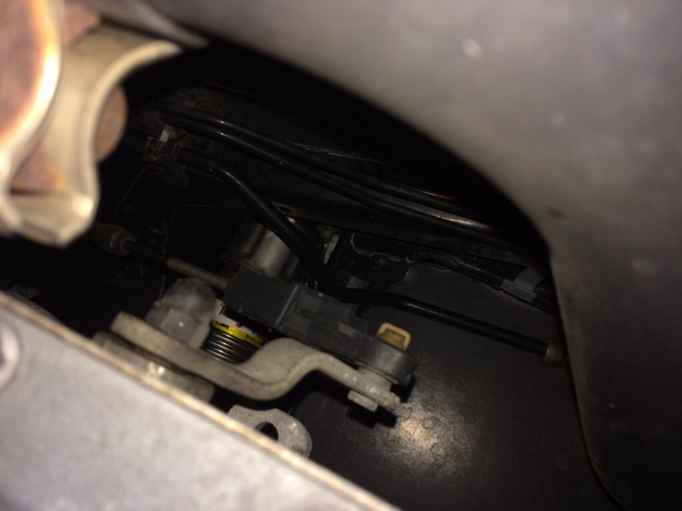

I had to get under Roxy today so while I her jacked up I decided to search for the shifter cable. Here's a few pictures, it looks good so itmay of been change before I bought her, would seem little odd as there was only 53k in 2011 ImageUploadedByTapatalk1444172688.019421.jpgImageUploadedByTapatalk1444172703.636037.jpgImageUploadedByTapatalk1444172773.658644.jpg
I was thinking about spray it with silicon or something to help preserve it. Any recommendations?

I had to get under Roxy today so while I her jacked up I decided to search for the shifter cable. Here's a few pictures, it looks good so itmay of been change before I bought her, would seem little odd as there was only 53k in 2011View attachment 5849View attachment 5850View attachment 5851

Could someone tell me which side the shift linkage is on the transmission before I crawl under the xlr. Driver or Passanger? Also is the shaft exposed or do I have to remove any cover to expose it?
Cable runs from shift lever to left (driver side) of transmission. You have to remove the H pipe (exhaust) and closeout panel to get to shift lever connection point. I can put up a pdf file on how to do it if you want. I let my shop mechanic do it after I looked at it.
