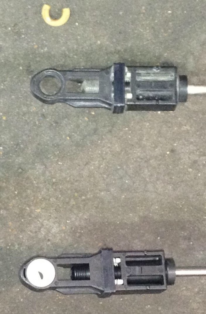

Shift cable broke
Driving my Stella (xlr) on 9/4/15 with the top down on a game night and getting the thumb up sign.went to get my mail and a snack then back home, pulled up to my garage backed up to go in and nothing. I was like wtf just happen,put it in drive nothing so I pushed it in the hanger to see what went wrong, I didn't have a clue. So I went on the xlr forum to see if anyone else has had this problem and Bam! There it was the shift cable gromment had broken, so after doing research I found out I could order the cable on gmpartdirect.com for $55 +tax three days later it came, now the real problem is how to fix it myself, so I jack my Stella up and laid under her for 45min to see how I was going to do this hard job, I study it and it hit me just replace the gromment,but the hard part is my hands are to big to fit in the tight space. So I was thinking tow truck and labor cost so I decided to call my friend with small hands to get in the tight space to replace the grommet, so I went and bought long needle nose plies and a 6 pack, and started the work. A hour later I was back on the road. Cost for the job was $65 for the cable I didn't used just the gromment I took out of the new cable, $10 for the plies and $50 for small hands. My Stella is back on the road.:):cool:
need some pictures!!
anyone figure out a replacement grommett (that isnt plastic) for a permanent repair?

I haven't had the problem to know the set-up. Is it a female threaded on one end ball clip on the other? So the trans arm has a ball stud on it? If so I know many ways to convert to a metal clip. Would just need the thread size on the cable and ball diameter on the trans lever. Probably gets brittle from the heat in the trans tunnel. :dunno:
Shift cable grommet
im going to post a picture in a few..
Yes that's it I just replace the Gromment at the Trans and shifter, I still have the new cable, but Im planning on modifying the new cable,so the next person will not have that problem.
Let's us in on the secret!!!
As far as I know mine may be the original she had 53K on her when I bought her in 2011 and 91K now! So want to be prepared I'm going to order a cable now so at least I have it when I need it!

Actually the whole thing needs to be redesigned!
Its a push and pull system, twisted cable in shield. There are only 5 wires in the twisted cable and where they connect to the shifter there is a moment exerted on the grommet connector (guaranteed failure at some time). I briefly looked into replacing the cable with a racing bicycle brake cable, but they're only 8 wires. The cable needs to be high strength, low volume one piece (vs stranded wires) and mounted in a way that eliminates the bend up front.
