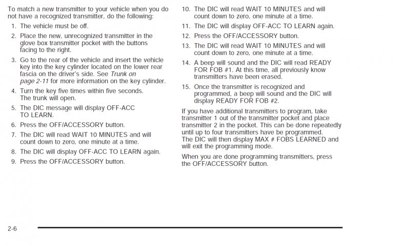

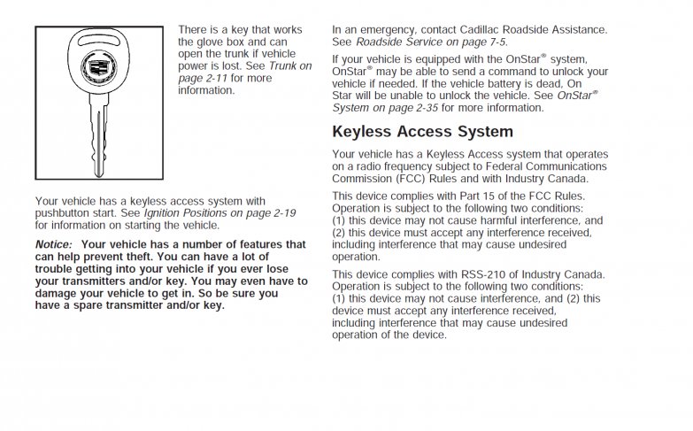

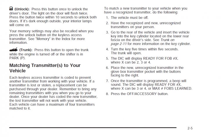

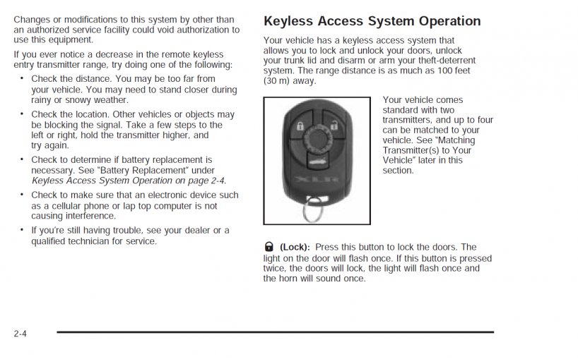

Find enclosed copies of how to program the FOB keys in case that you do not have an owner manual and check your programmations steps made in order to confirm your work.

in answer to part of your question. the key slot In the bumper is a mechanical cable release and just unlocks the trunk when there is loss of electrical power to the car.. It should not have anything to do with the hydraulic opening and closing of the trunk.

I successfully programmed the new fob (it was new, but looks exactly like my old one). I purchased it on EBay and it came in a GM package. The battery in the fob was new.

You are incorrect. If your battery is good and you place the key in the rear slot and turn it and hold for a second, the trunk will open. Also when you are programming fobs, you have to turn the key five times quickly to get into program mode and on the fifth turn the trunk will open. There is an electrical as well as a mechanical connection.
