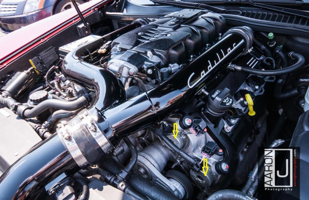

Part #s and even a posted picture of the cover off, part location on the heads would really help us newbie owners. Buying spares sounds like a great suggestion
Here's a pic of my pretty clean engine compartment with the engine cover off and arrows indicating the location on the sensors on the drivers side. There are two just like them on the passenger side. :chuckle Click on the picture to enlarge it.

Thank you for the picture,,
Thank you Cubby for the picture,,,that gives me a clearer picture of the part in question. I was thinking it was something like this below, but apparently I was wrong:
Engine looks nice, Cubby! Did the Cadillac script on the pipes come with the D3 treatment or was it added later?
They were added. It's the script from 1955 Cadillac valve covers.
