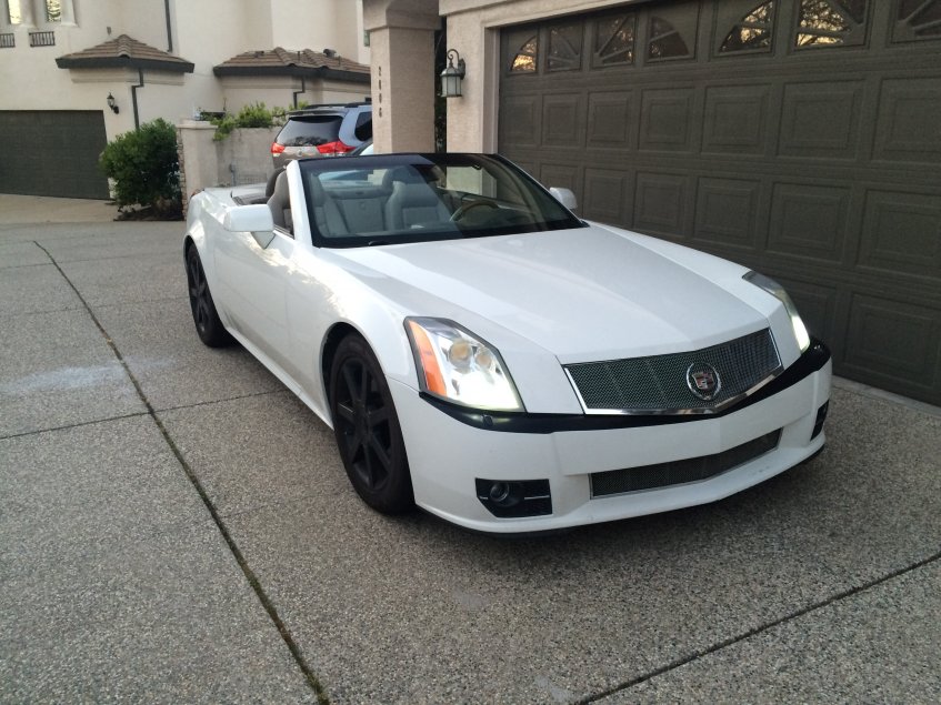

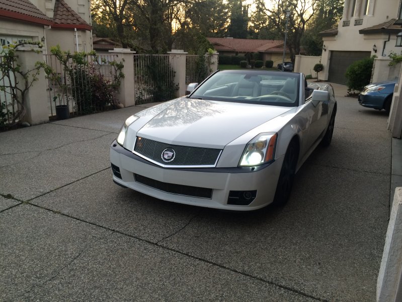

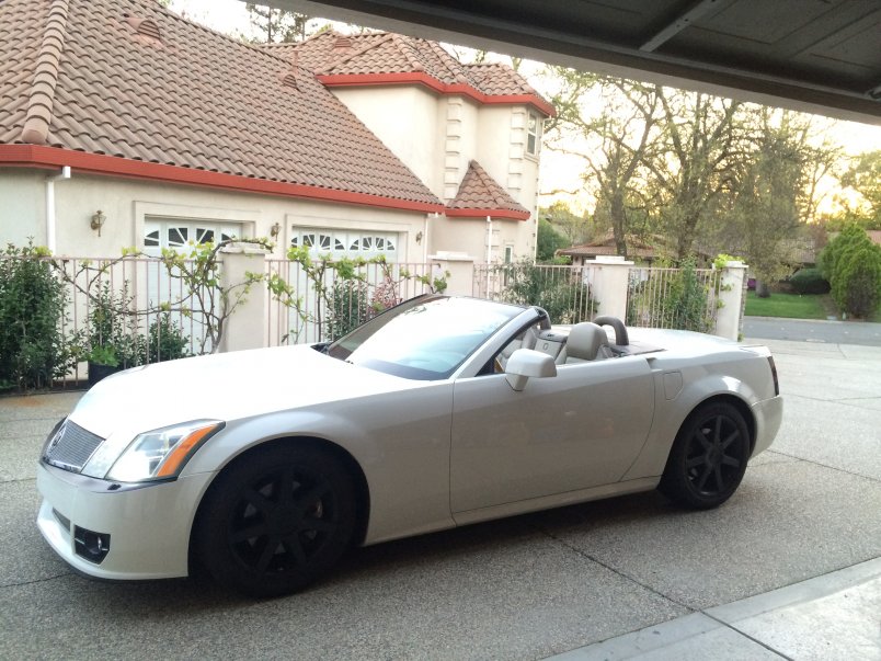

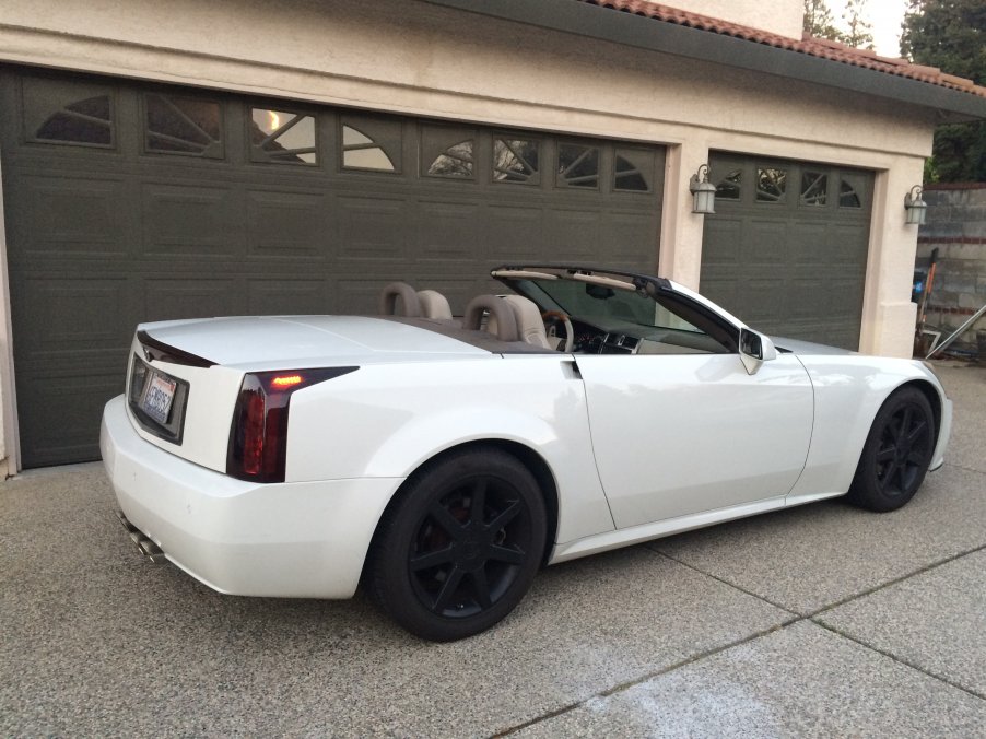

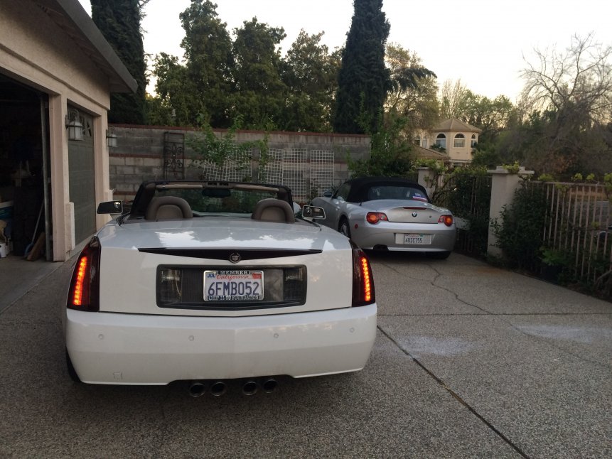

... And now for the photos as promised; they're not spectacular, but at least there are some pics, so you know the car does in fact exist. hah.
crap it won't let me attach. Ill figure this out and post shortly...
here we go:
she's a real head turner!
definitely worth the effort to get her back on the road.
at that mileage, might just go for a flush and fill on the coolant??
most caddy and chevy dealers always running specials on coolant.
my local corvette dealer will do it for under 100.
the coolant on the N* needs to be fresh.
then you know its good fluid , burped properly etc.
That's a good idea... I'll probably just have my mechanic do it- I cant cheat on him after all these years. Haha
