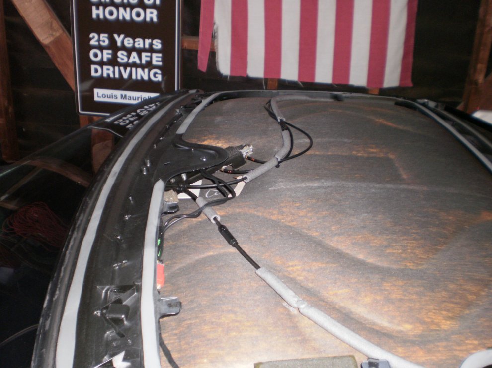

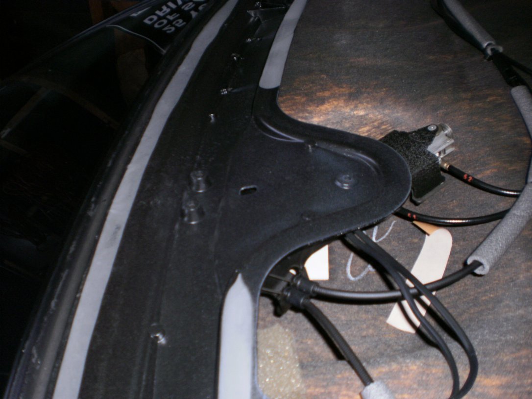

thank you. the reason i even thought about that, is because the new top i'm installing still has the same bonding as the one that failed. i thought that maybe they have improved the bonding agent, and process since 2005. i also noticed yesterday while looking at the frame, the front middle didn't even have any bonding on it. i'm going to try to post a picture, to show you want i mean. that is the area i was hearing wind noise.

Nice pics.
All parts are created equal . . . well, sort of. While both (top panel) parts may be from an '05, it doesn't mean the new(er) roof panel will suffer the same fate. Combined, the number of 2004 and 2005 model year XLRs outnumber the rest built up to 2009. While horrible, your problem isn't common, so I wouldn't really worry about a repeat performance - unless the bond joints are showing signs of splitting. I would definitely replace the windshield header weather strip at the bare minimum as a precaution.
The headliner ought to be easy to remove (easy access from the top!) but make sure you place a tarp across the entire interior for protection. If you do the job yourself, take lots of pictures and use a Sharpie marker to highlight alignment points - it can easily be removed with IPA. (The other kind is for drinking.) Don't place any undue strain on the hydraulic lines to the header latch and Folding Top when removing components. They can become brittle over time and any spilled oil will trash the interior.
