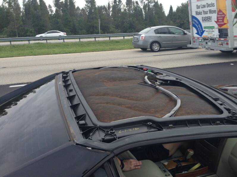

I'm posting this because after a long search online, I found nobody who had this issue, despite the Cadillac dealer telling me that this is a "common" problem.
This is my 05 XLR, it started to get some wind noise and I figured a seal had started to wear. Dealer looked at it and said the same and recommended a silicon product for the roof seal.
Then while driving down the highway at around 70mph, the roof panel flew off the car. Thankfully it didn't hit anyone or cause an accident.
So, make sure you get your wind noise checked. Apparently this was an issue with Corvettes around that time, but I've seen nothing on the XLR.

I had the same issue last year. Took it to a body shop, they used the strongest glue they had and glued it back down and clamped it down. It had popped up enough that you could see a tiny crease where it contacted the frame while it was in the retracted position. Haven’t had an issue since then.
report to cadillac
If you have had any issues with the roof on your 2005 XLR you need to make sure to contact Cadillac. they are looking into it but say there is not enough widespread claims to make a recall. So unless you report it and make sure you report it to
NHTSA so that it is on record. You can check to see if it is loose by just pressing on the outer edge and seeing if there is any movement.

It happened after I sold my XLR to my father... We live in South Carolina. I was moving it back to my garage to avoid a terrible storm (he lives in an area which floods) and while traveling on the Interstate going at normal speed... next thing I heard was a WOOOSH and then felt a draft overhead. I was EXTREMELY lucky that nobody was behind me at the time and the top fell alongside the shoulder when I went back to look for it. We took it to the Cadillac dealership and found out there was additional damage causing the sensors, pump, and other parts to not work correctly. The top itself also needed to be fully replace due to the damage after it fell on the highway. They tried to replace the roof and additional parts but the insurance eventually totaled it after weeks of sitting there. To be honest, as much as I loved the car I'm glad it's out of the family. I just don't understand why they used adhesive instead of something else. :/

the whole car is basically glue (bonded I think is the correct term) to the frame. the inner fenders are glued to the body and frame . the two door parts inner and outer are glued to each other,, The inner and outer hood are glued together .Its a product that has worked well for 25-30 years so its just like some welds on newer jeep frames are failing , you can have product failure no matter what you use or how well its been tested. what color was your car and how long was it In Carolina. I would be interested if it had been in a shop with paint work being done on it at any time. I really see no way that the top blowing off would have caused other damage to the sensors unless it was In the rain and the same parts that fail on a lot of XLRS got wet. the top delaminating has nothing to do with the pump. Most likely the shop screwed up something in opening and closing it to remove the inner support of the top. that has happened to many on this forum.
There was definitely some type of screwup at the shop... we waited weeks for a response. Every time we thought they were done they said they needed more time. Unfortunately it was raining hard that day when it happened. :/ It was black and always stayed in Carolina.
