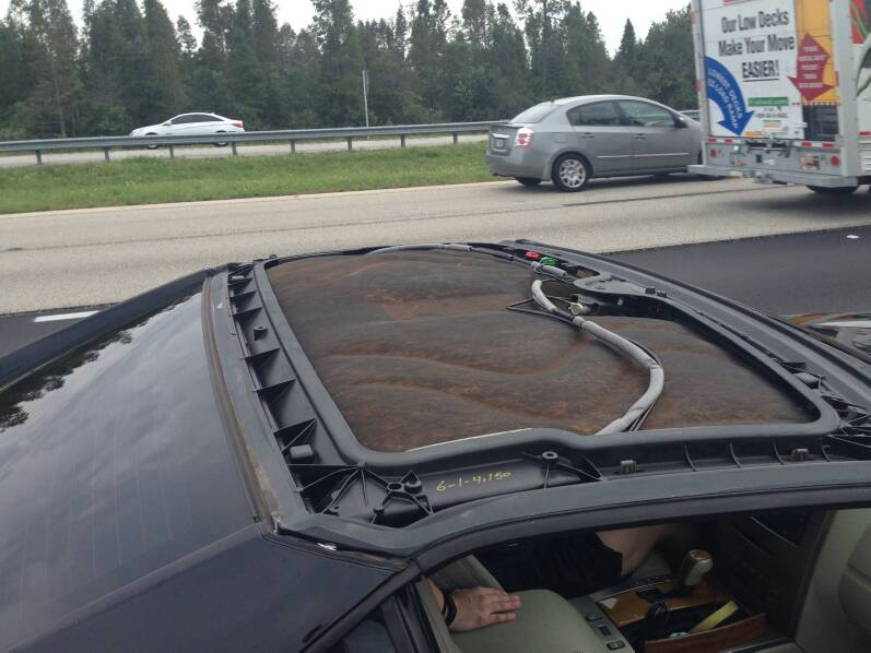

I'm posting this because after a long search online, I found nobody who had this issue, despite the Cadillac dealer telling me that this is a "common" problem.
This is my 05 XLR, it started to get some wind noise and I figured a seal had started to wear. Dealer looked at it and said the same and recommended a silicon product for the roof seal.
Then while driving down the highway at around 70mph, the roof panel flew off the car. Thankfully it didn't hit anyone or cause an accident.
So, make sure you get your wind noise checked. Apparently this was an issue with Corvettes around that time, but I've seen nothing on the XLR.
Yikes! Thanks for sharing that. Interesting to see what it looks like under there - but not a way that anyone would want to do it!
Wow, ejecto-rama! Glad it didn't turn out worse for you!
Despite what your dealer says, this is NOT a common XLR problem, otherwise the NTSB would be replying to your post - not me. This is the first time anyone has reported this type of issue online in any XLR forum. Obviously, the top section yielded - a close-up of the leading and side/corner edges would be interesting pictures to post. Were you able to recover the top panel?
As for convertible corvettes, they aren't even close enough in operation to compare, so whomever told you they were having the same issues was misinformed. A Google search should put that rumor to rest. (No TSB's have been issued for a top flying off either, just complaints of headliner separation, which is bad, but not hair-raising.)
Because it's a safety issue, I'd bring it to the attention of the Regional Service Rep and see if GM engineering is interested in getting involved.
Keep us informed please,

The repair guy at the dealer said he had seen this "a few times" - so perhaps common was too strong of a word.
I did recover the top panel. It flew off like a frisbee, but thankfully it only got a few small scratches. Didn't snap a picture of it. It's with the shop now being repaired.
And yes, that's what I referred to with the vette issue. But I couldn't find anyone online who had this issue with the xlr.
Hopefully if someone is getting wind noise they check it out before it becomes this. I got lucky that it didn't cause an accident.
Thanks for supplying the NTSB reference. I was able to find more info on the corvette forums. GM was/is fixing the tops, but the XLR hasn't gotten the visibility (yet) and this may be an isolated failure. CTS built the XLR tops (and supplies them for the Mercedes SL) so hopefully, this won't become more prevalent as the XLR ages.

You said you took it to the dealer. Sounds like THEY caused the problem by removing panel and putting silicone on. This is not correct.
I had a top replaced on my 05 Corvette for this same problem. GM had a problem with their adhesive for a while.
