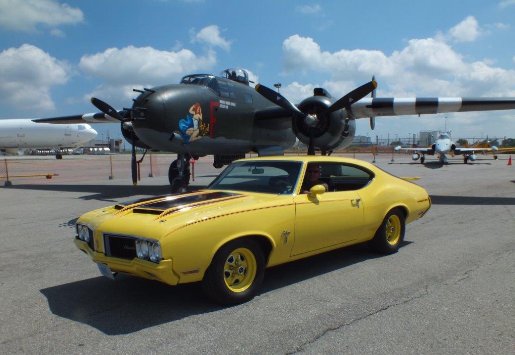

They had an Autocross set up at the Syracuse Nationals this past weekend but we didn't bother: we were there in the 1970 Oldsmobile Rallye 350 (Cutlass) and that thing feels like a Boat going around the corners.....:laugh:
No good on Autocross for sure but it sure looks great in front of a B15........
