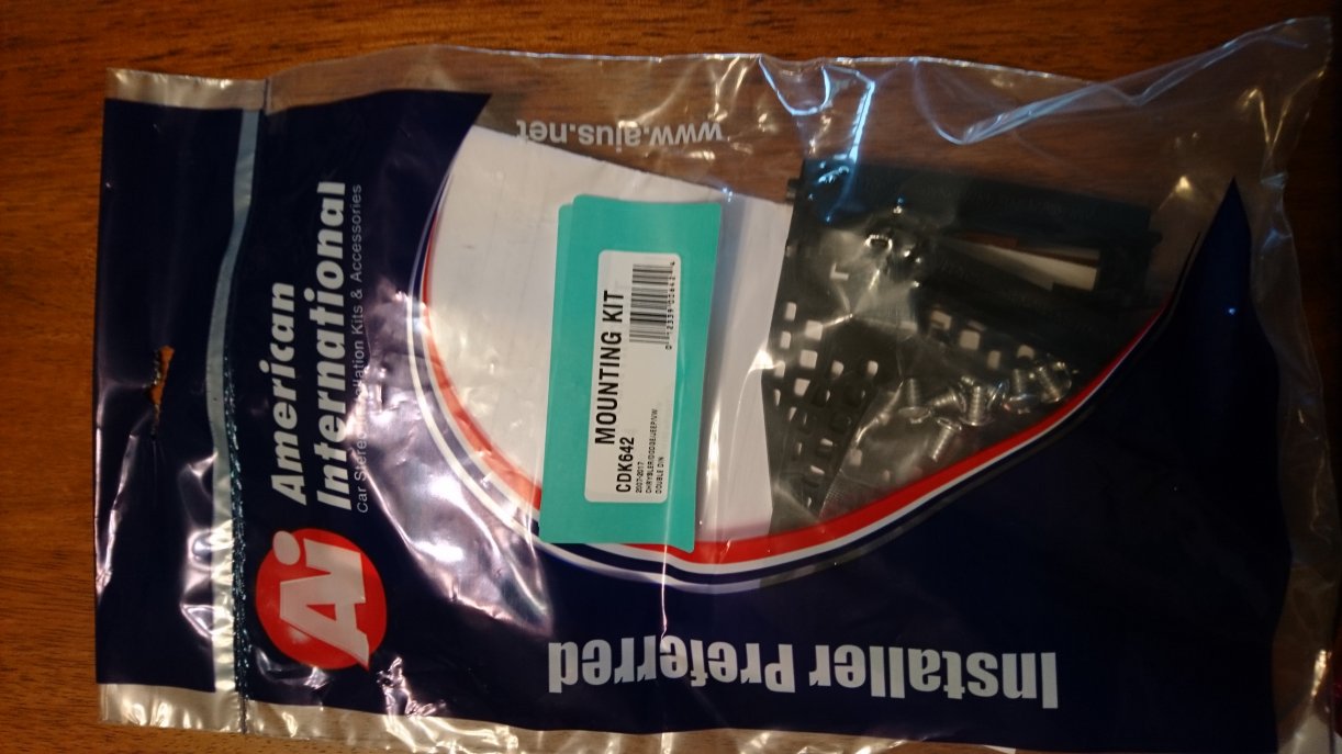

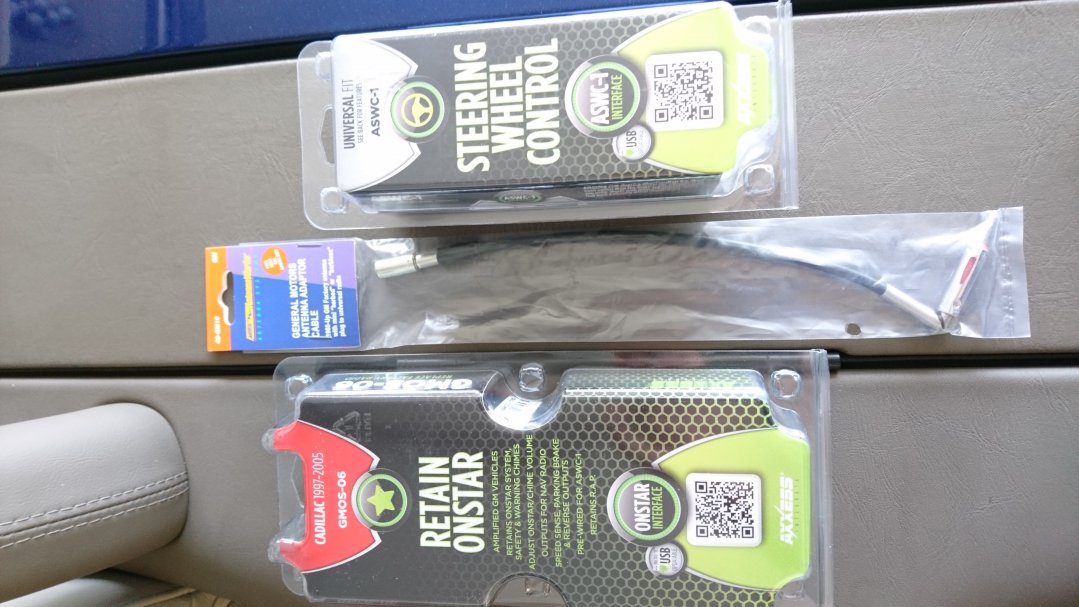

Following Rexter's lead, and others, after finding the right master audio-tech installer at a Best Buy in Kingsport TN, (on rec of my dealer's service mgr who told me this guy was "the man" in these parts for anything car audio installation), I took the plunge and could not be happier with the result.
Mine is a 2005 XLR and the gear my guy used that resulted in all systems "go" (except heads up display for radio info---heads up for mph etc still work), was as follows:
the unit, a Kenwood DNX893S
GMOS-06
ASWC 1 Steering wheel control
GM FWD Ant adapter 85-13
SiriusXM SXV300v1 tuner kit
I think the installer did a couple custom connections to make everything work. Did not need the PAC TR 7 trigger.

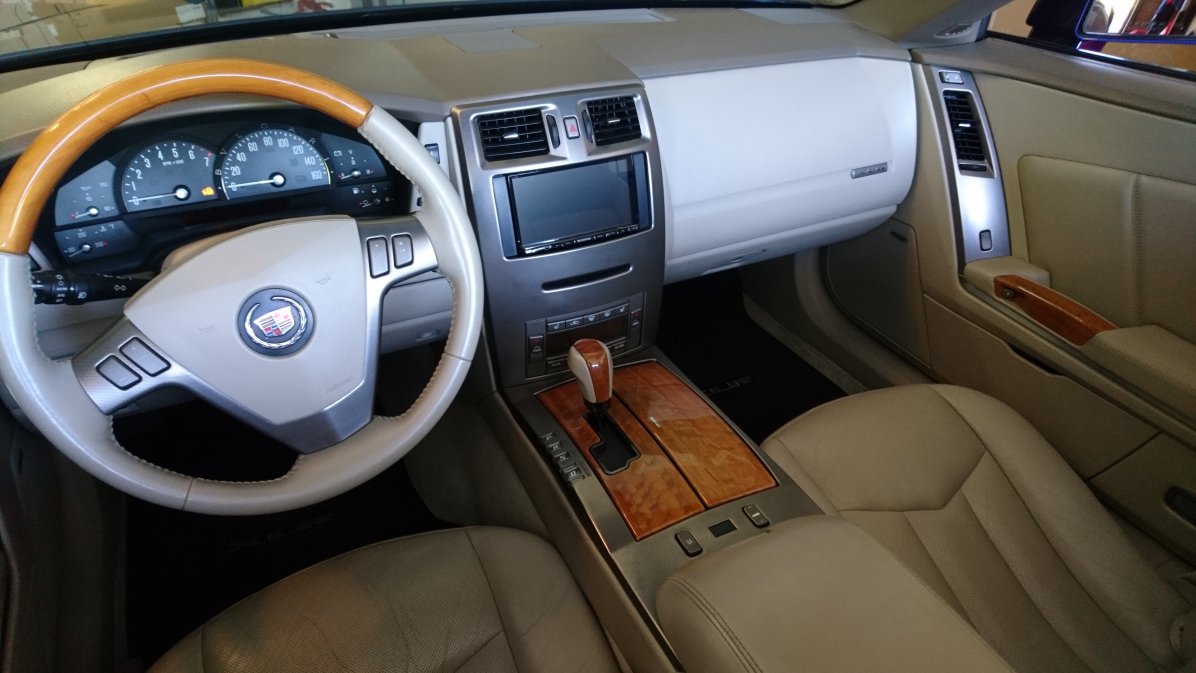

Have the use of all the advanced audio controls on the new radio. Steering wheel controls work great.

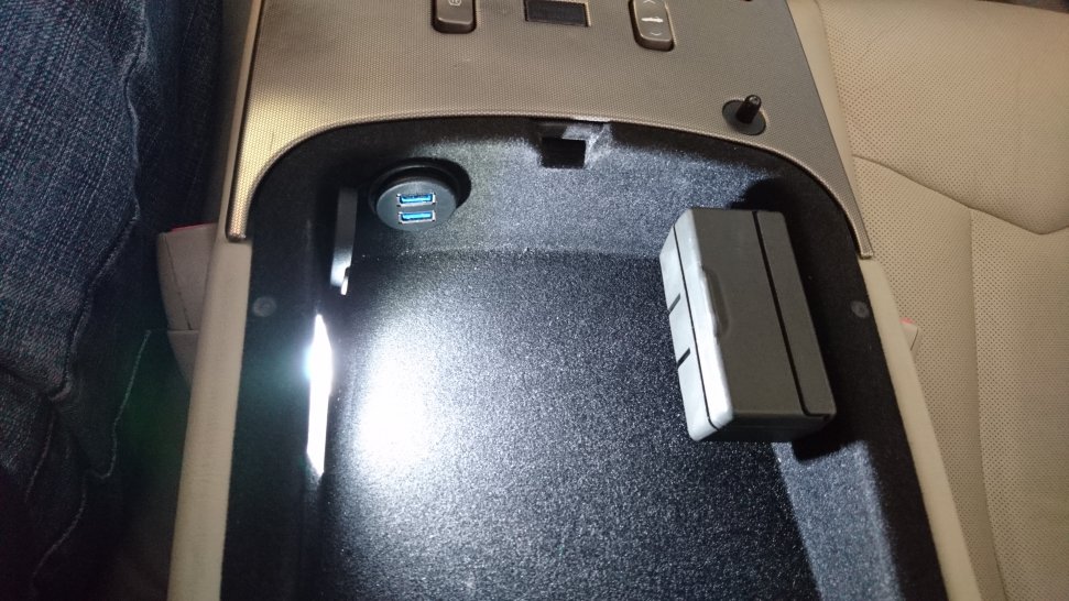

Only lost the onstar which I never used after free script ran out. Two usb plugs are in center console. Sat antenna in upper right corner of windshield, nearly invisible from outside; can't see from inside.
Looks outstanding, with some custom trim he installed. Will try and post photos later. Could not be happier.
Total cost of everything: $1550.

One of the USB plugs is strictly for an iPhone/Pod playback. The other is for other USB uses.

The unit looks great installed.

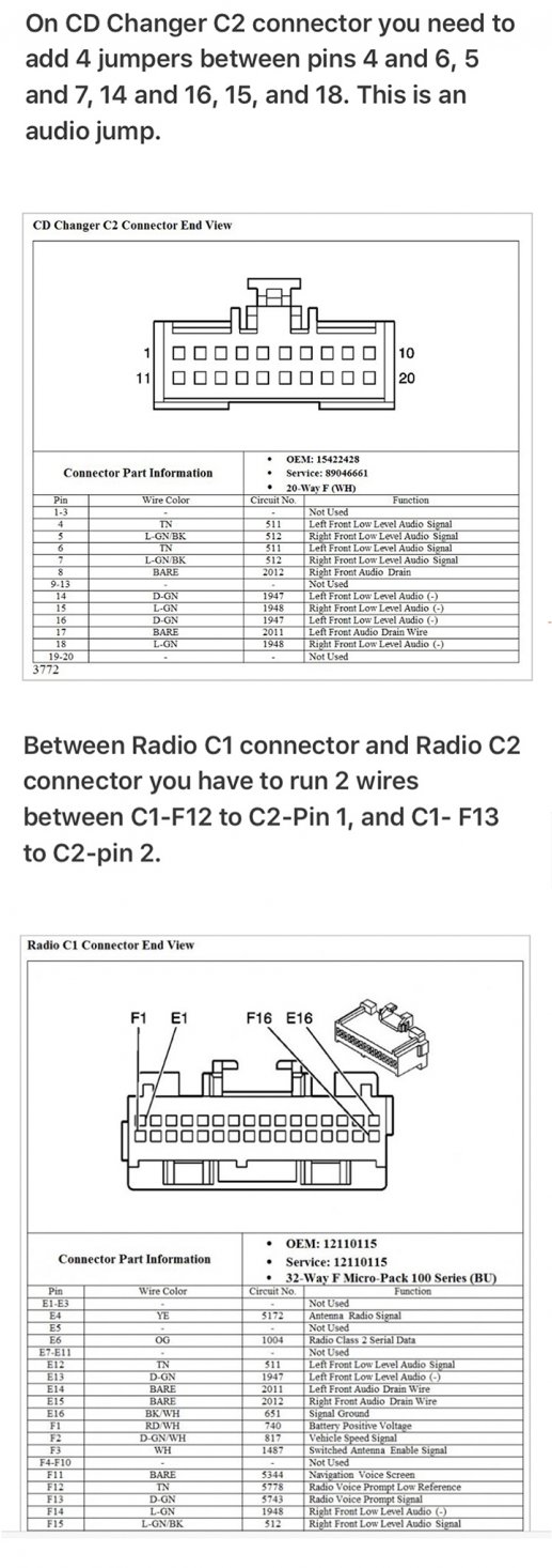

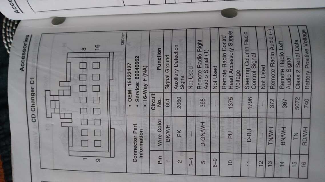

I wanted to update this thread a little. I've attached the wiring instructions for the speakers that had to be done to get the sound out. Thanks to 64rdc19 I've taken his pictures and combined them into one image.
With the information already here, and with this addition, this should be a definitive answer to how to replace and upgrade the sound system in our X cars.

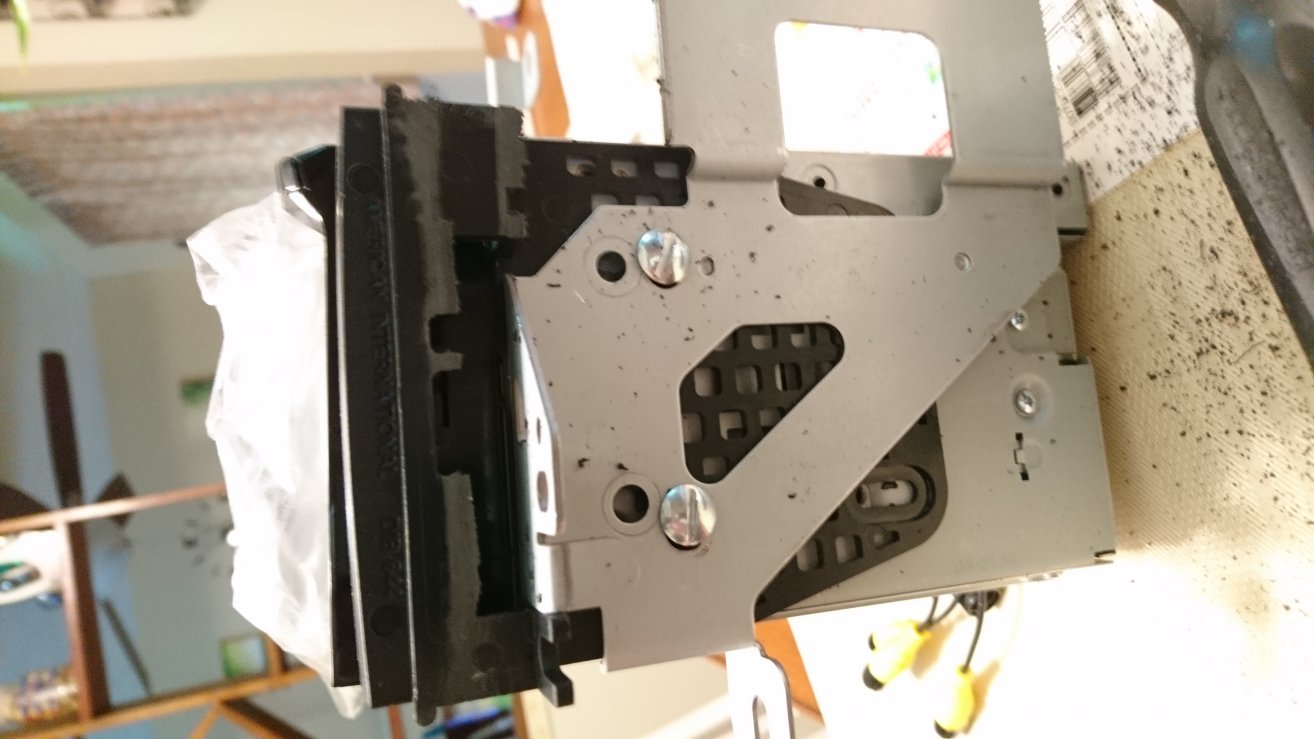

Thanks to everyone on here with the great info I just finished my Kenwood radio install. I was over thinking when looking at the schematics and just wired up with parts and info on here. Everything works great! I did have to drill a few mounting holes on the cage and also called metra access to program buttons on steering wheel controls. Make sure you don't use wire taps for the steering or it will not detect...too much resistance on wire. I also removed cigarette lighter and put a USB adapter in its place. Android carplay is awesome! Sounds great but can't turn up too loud because it's way more powerful than OEM and speakers distort.
I did post a few more wire schematics if it will help anyone. Thank to everyone on here for the awesome info.
