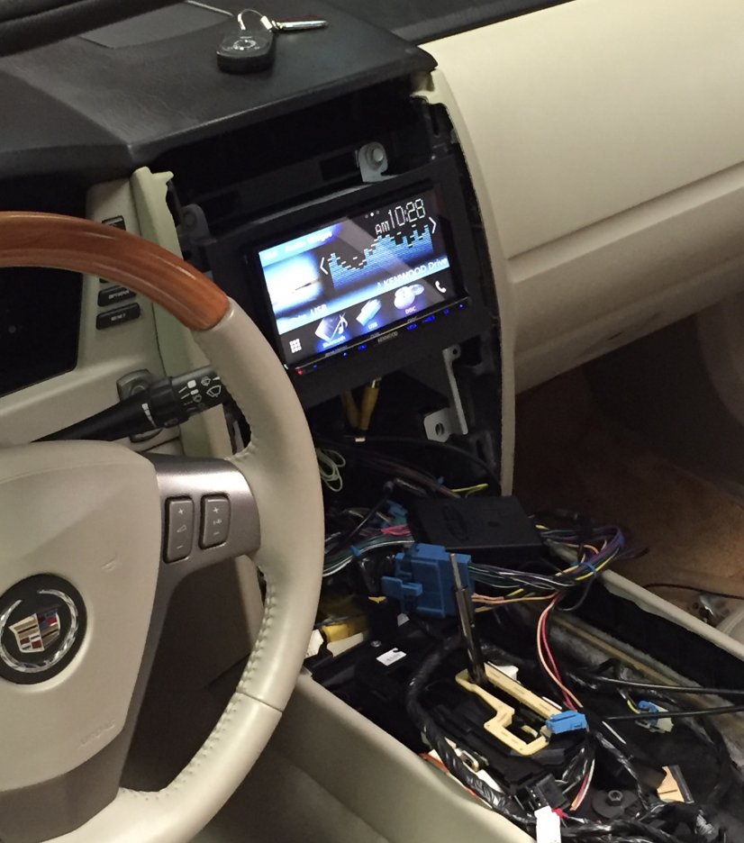

When I was trying to get the stock head fixed/replaced, I can pretty much look at my dash and it starts pulling it self out.
So again when I came home tonight my car was in more pieces, with the waterfall out & various pieces of plastic trim that go around the passenger seat out. BUT, we have power and sound and it sounds GOOD!

Currently he's working on installing the backup camera (the waterfall was out because he was hoping to route the wiring through there, no dice so it's going along the interior passenger side, under some of the plastic), & getting a good ground connection. Microphone is going above the rear view mirror, he ran the wire through the A pillar. Steering wheel control hook up is next on the list. GPS is picking up its signal using the OEM antenna, tested OnStar last night & it's also working.
Not a fast at home project - perhaps a little longer since he chose to solder together a number of the connections - install work started last weekend & he's been working an hour or so on it each night during the week. He's familiar with electrical work so that helps. And obviously a lot of the car needs to come apart ...

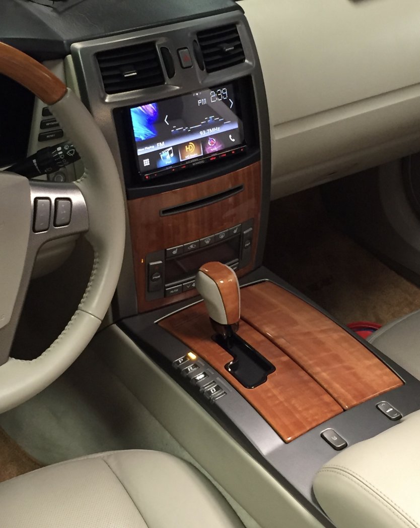

Ta-dahhh!
Unbelievable how Mike put back all the wires & pieces pulled apart so you'd never know it happened!
Everything works, got my iPod set, steering wheel controls all work on it & the radio. There was some confusion from the steering wheel control co. (Axxess) between using the instructions that came with it & the XLR-specific ones on their web site. If you do this install yourself, got straight with the right customer service rep to use the XLR specific instructions.
While he was at it, Mike fixed an issue with the transmission gear selector lights on the console so they light up nice & bright now. Now he's finishing up the back up camera install.

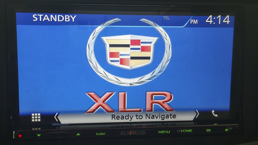

Use Photoshop and make your own background wall paper to really personalize it

Saw your earlier pics where you did that & I'm already planning on it!
