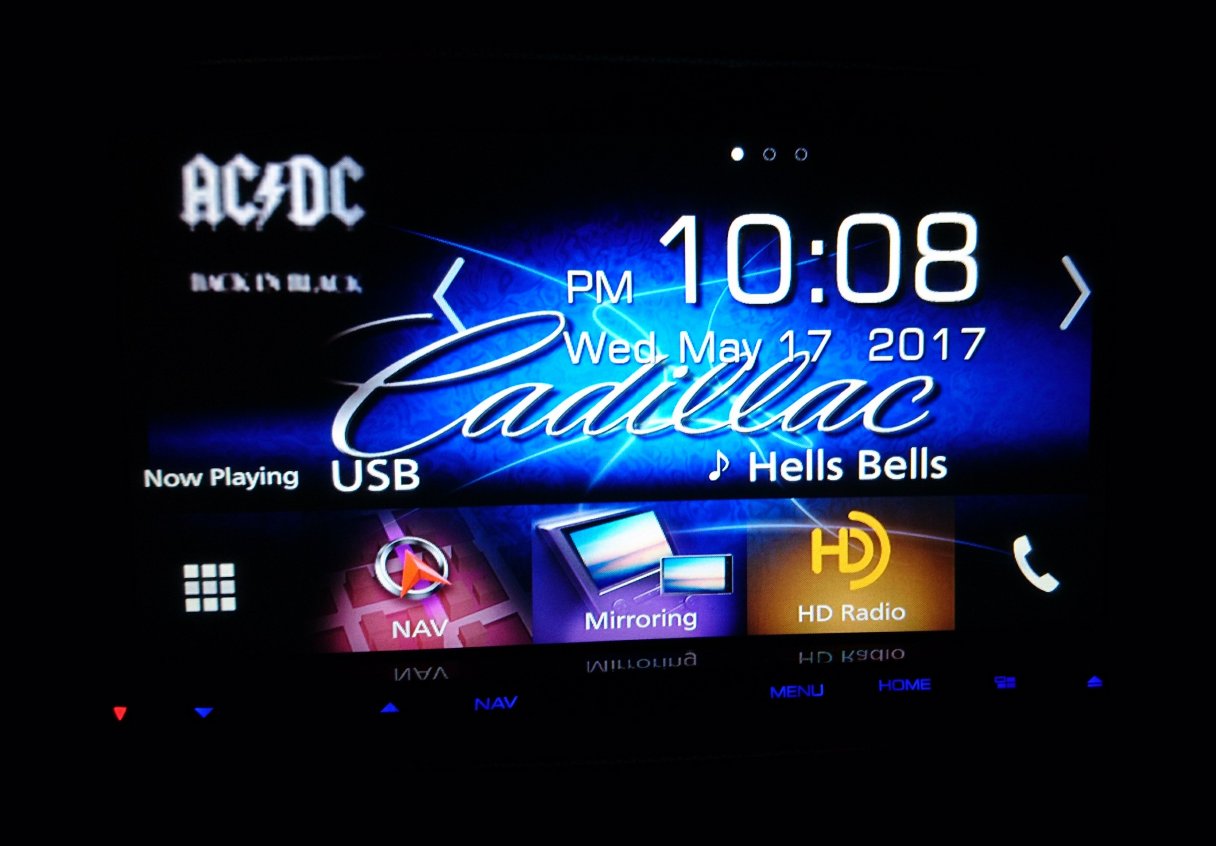

So many cool options on this! Changed the background picture to this nice Cadillac logo. Plugged a USB in with 1200+ songs and reads very quickly. One of the best upgrades I could have done! I just hope that I don't blow the speakers out lol. Thumbs to all!

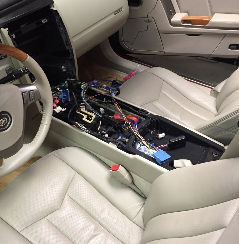

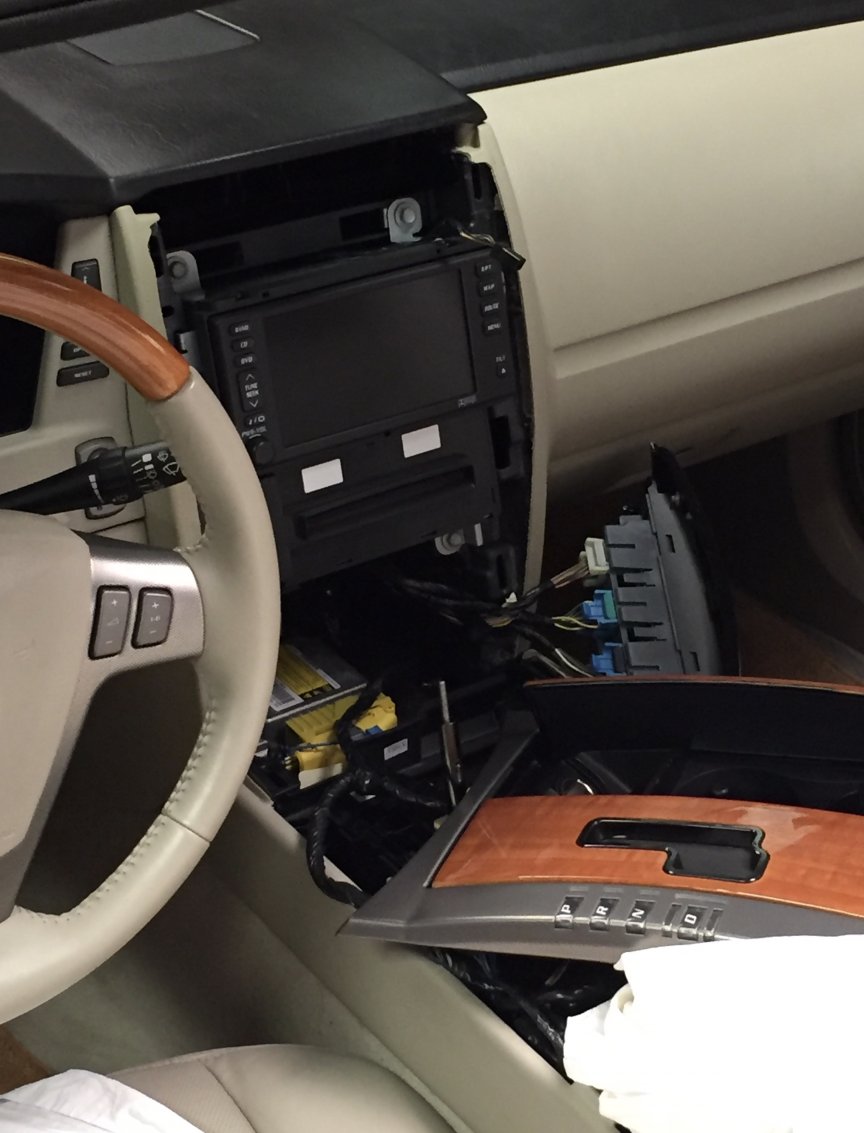

Initial stages of working on installing the Kenwood. Looks scary to me! - but Mike knows what he's doing.

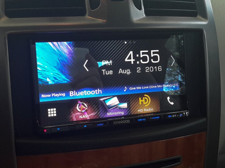

Looks like the Kenwood DNX893S is going to work in my XLR. They are buttoning up everything now after about 3 hours. Added a backup camera and Sirius/XM. I'll update as soon as I take possession of the car.

The owner was very good in trying these adapters out, even though every catalog does not list them as suitable for our XLR vehicles. At the very least I would get an updated Nav unit in my car with sound bypassing the Bose system using the Kenwood's amp along with a much needed backup camera. If everything worked as hoped for, I would retain OnStar, Bose, and all the other things that go along with it. I would also retain control over the steering wheel controls as well. After a couple of hours in the shop, the owner came out and said everything was working, Bose, OnStar, backup cam but they had no sound output. I immediately pulled up the wiring diagram that is in the thread "App Radio" and showed it to the tech. He had me text him the link to h is phone, he pulled it up and within 10 minutes we had some serious sound coming from the Kenwood. So I have a new Kenwood Nav unit, with HD radio, Garmin navigation, Android Auto, bluetooth phone and music plus DVD that can play while driving if the passenger/co-pilot wants to watch a movie. I'm not sure I'm going for a Sirius/XM tuner as I have it on my cell phone and can port it over to the Kenwood via bluetooth, time will tell and it's an easy add-on later
The steering wheel controls work for the volume up/down and instead of "Source" for the smaller button it's a scan button for whatever media source

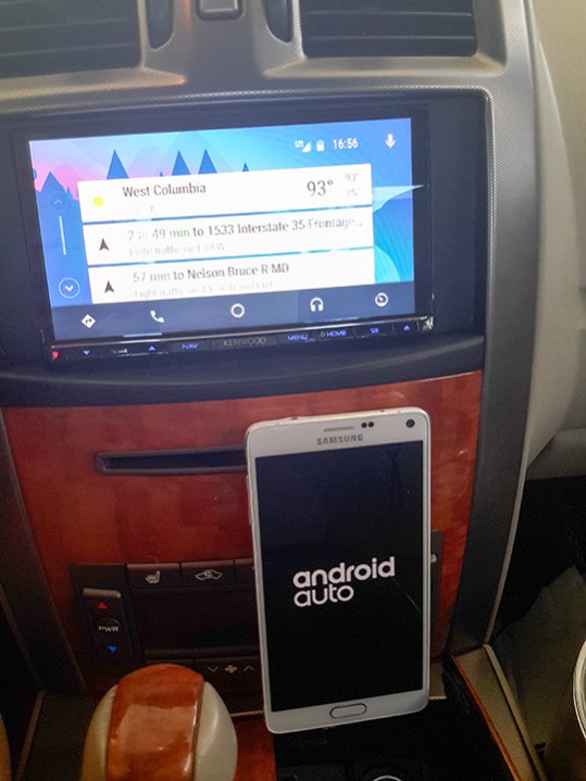

My install was 8/2/16, works perfect, Android Auto is cool. There was an update for the Kenwood last October if you haven't done it

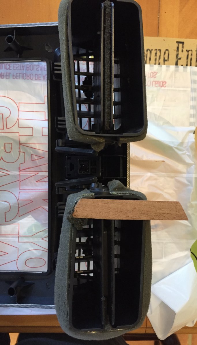

Speaking of time, since the entire middle section of the car is out, decided now was a good time to clean out the stupid sticky disintegrating foam from the vents (horizontal piece in the middle of the vent; the foam around the outside is actually in ok shape). Basically need a tongue depressor size stick to get it out. Going to gently blow air through the backside before reinstalling to be sure it's all out. I hate that stuff! :mad:

I've done the same thing in addition to the arm rest vents as well. When we first got the car, every day on startup I'd get little balls of goo fly out of one or more vents. Get on our clothes and the seating area. Just old age makes the foam disintegrate, pretty much like I'm disintegrating
Blah! My car is destroyed! (Not really, install is still in progress, but it's still scary looking - especially since every time I come home it's been taken apart even more).
