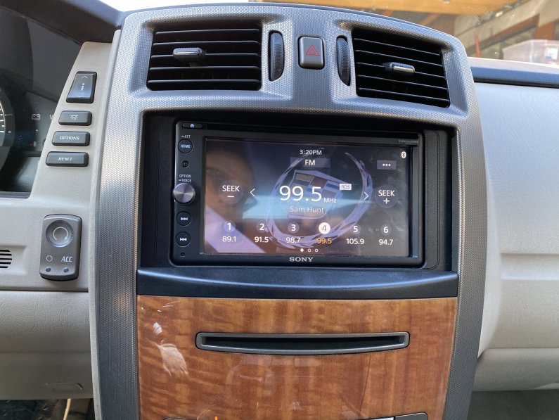

And to add to What LT Sally said, after putting in my new Sony system, with rear-view camera, built in radar jam/ detectors the works—you do not, as many have said in various posts, need to keep the original radio BUT you do have to keep the original amp—as that's what feeds the signal to the ACC—so if you want cruise control keep the amp, it has a proprietary signal to make the cruise work. I actually got a new more powerful amp but still had to parallel wire in the old amp regardless...new system is awesome and everything works just as it did before and everything is in the dash (or behind the double DIN). Good luck.

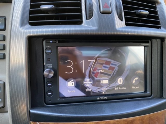

Yes, the Push to Talk just connects me to Siri in ApplyPlay and the SCRL takes through the various parts of the audio, cd, radio, phone, AppleCarplay, etc The Vol works on the new DD for radio, phone or CD, etc and the channel button goes through the radio stations or tracks on. CD...so everything works except the radio station no longer comes up on the HUD...who cares. Here is a couple pics of the installation We installed a Sony XAV-AX210 and a new amplifier keeping the old amp, as mentioned, wired in series
