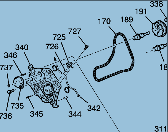

I will pay money for someone to tell me what part number these actuator cover gaskets are.......The dealers I have been to can't find them on any diagram.
I will check with my dealer repair shop and see if they change them on mine in January when they change a bunch of my gasket! If not may they can still know WHAT YEAR IS YOUR & BASE OR V???
How much moola? Drumroll the manual says " apply a 2mm bead of rev sealant GM p/n 12378521 or equivalent around the flange of the camshaft position actuator magnet". Probably why they leak all the time. No gaskets.:blinzel:
Here is the diagram. Underneath Part #735, that's where the oil is coming out.
