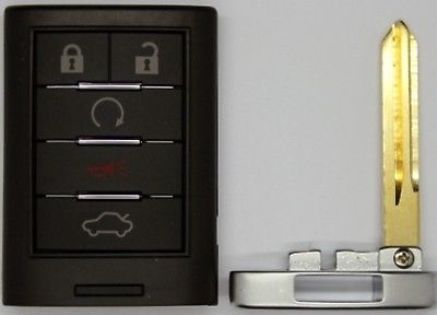

Be be sure to check with the seller that it has an UNCUT key inside. The eBay seller I purchased mine from had an advertised UNCUT key. Here is another listing on what I mean.
New 08 09 10 11 Cadillac cts STS Smart Key Keyless Entry Remote Fob w Key | eBay
I sent the seller a message asking just that... His response was these are brand new still in factory packaging, blank keys and all and have never been opened let alone cut.
I'm suspicious only because the picture on the one you listed doesn't show the button by the silver key ring under the trunk picture. See below.
Your back up... I wondered whether it was long enough to reach our back up key hole. Did you have any issues with that at all?
The key inside is a little shorter than the actual key but if you push the bumper in slightly it will give enough room to turn the key without rubbing. :wave:

My dealer charged $60 to erase all FOBs and reprogram the new FOB as #1. I had the programming steps to do it myself but we were leaving for BG Homecoming soon and I didn't want to mess something up before the trip.
The remote start does not work. The lock/unlock, trunk and the panic are the working buttons.
Thx and the picture you posted here is that the correct ones for our cars

New style FOB
I have one of these new style FOB's I'd be willing to sell. It has the 'uncut' key included. PM me and make an offer.
